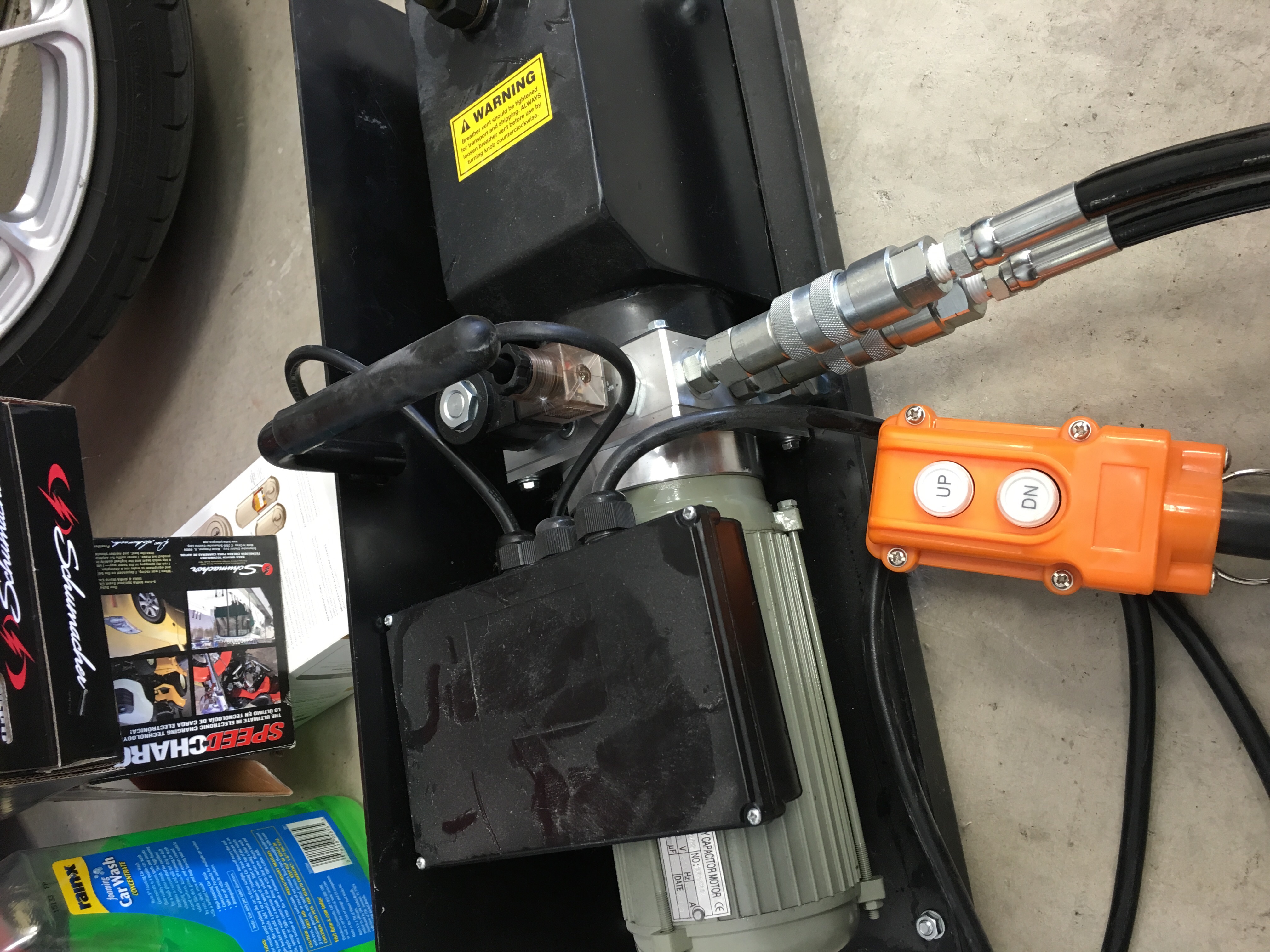

Sounds like it's a pump issue. I have seen 2 post and 4 post fail as well and 99% it's the pump if there are no leaks.
Just curious. What model do you have? The SLX version or previous? I know the pump were different. Mine looks like this

Its the SLX

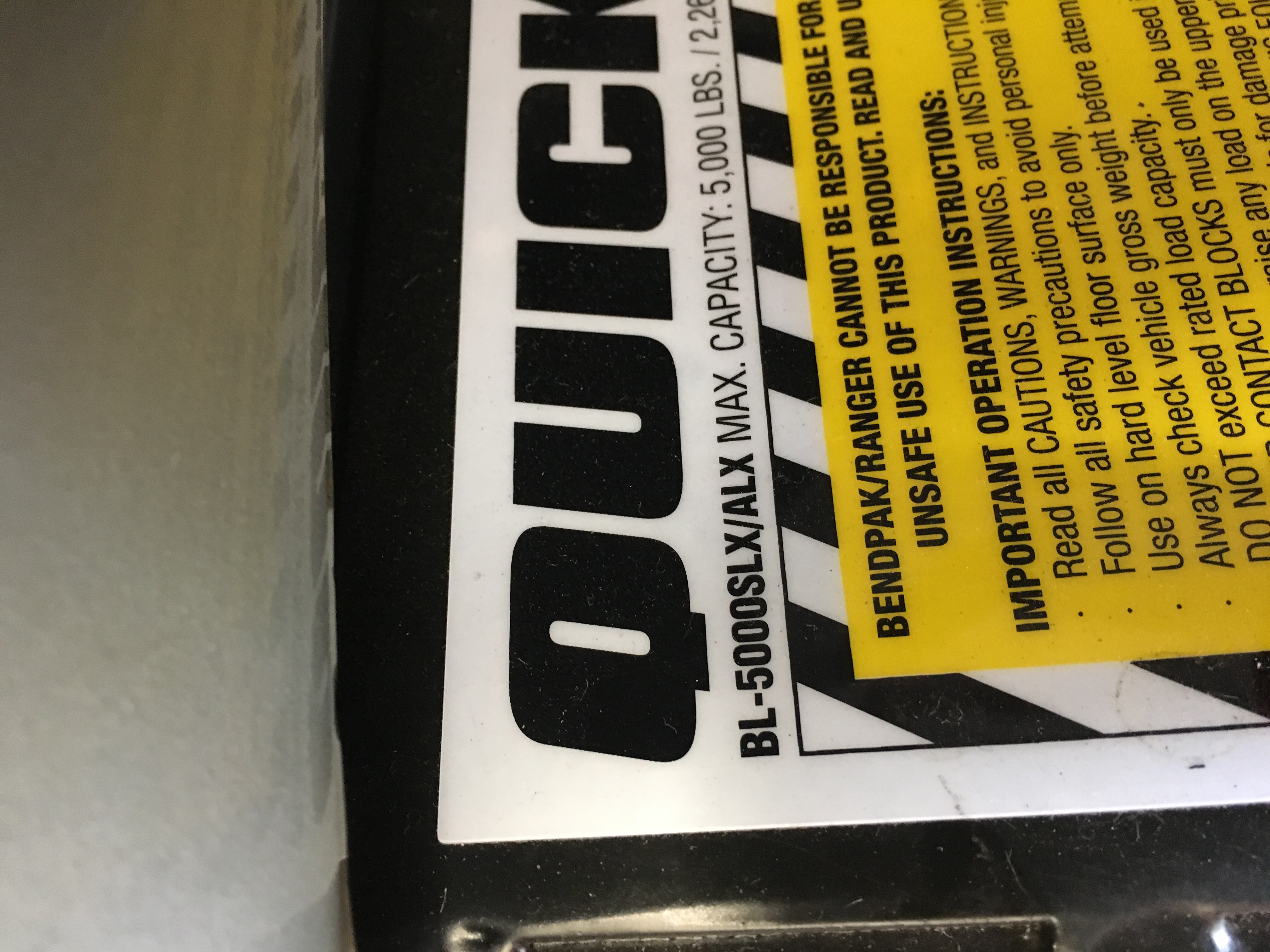

Old Jul 4, 2016 | 11:51 AM
  #35
Marpir821's Avatar
Joined: Jan 2010
Posts: 1,398
From: Columbus
Rep Power: 192
Marpir821 Is a GOD !Marpir821 Is a GOD !Marpir821 Is a GOD !Marpir821 Is a GOD !Marpir821 Is a GOD !Marpir821 Is a GOD !Marpir821 Is a GOD !Marpir821 Is a GOD !Marpir821 Is a GOD !Marpir821 Is a GOD !Marpir821 Is a GOD !
Yours looks a little didferent.

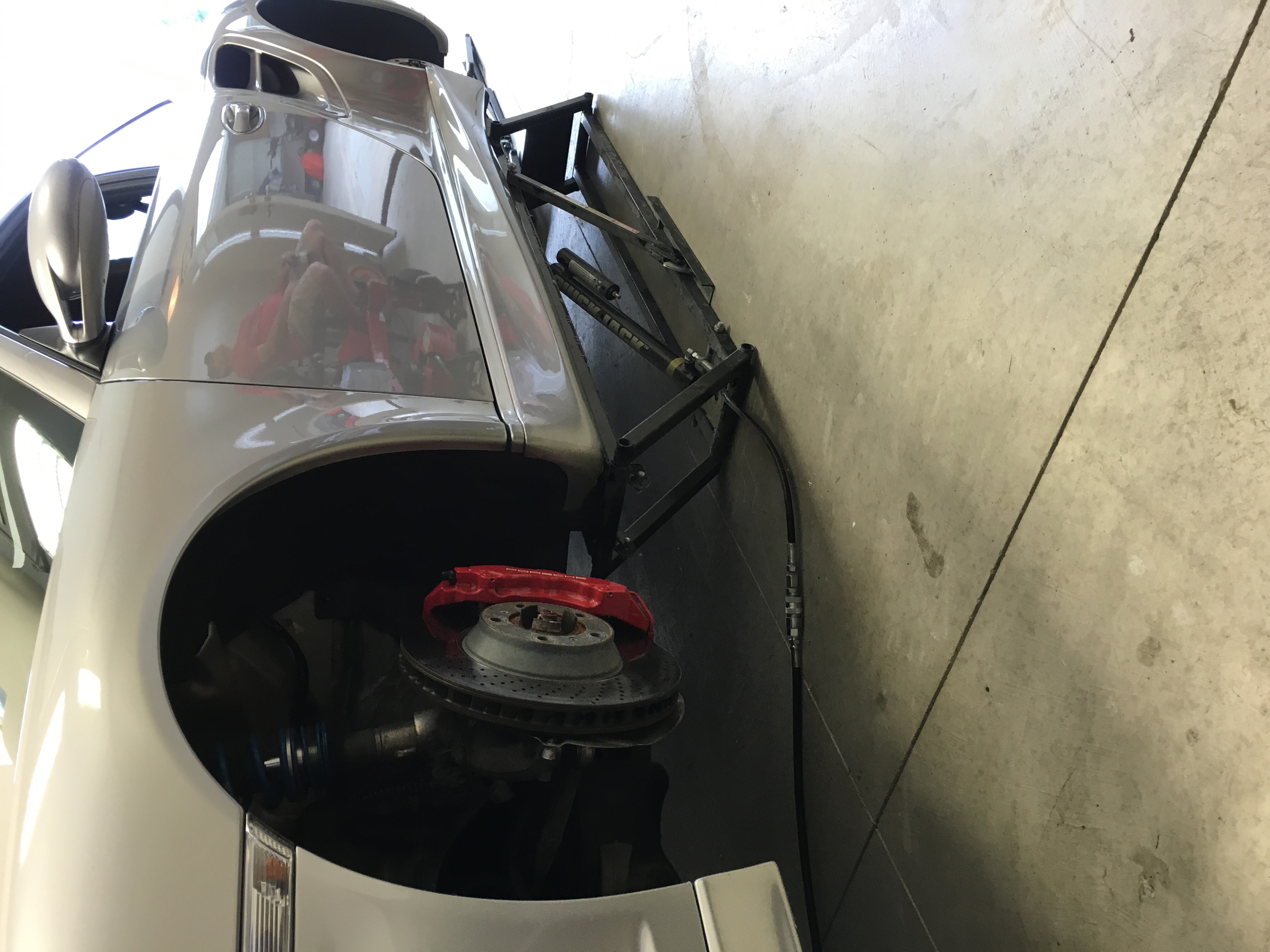

Old Jul 4, 2016 | 02:09 PM
  #36
Marpir821's Avatar
Joined: Jan 2010
Posts: 1,398
From: Columbus
Rep Power: 192
Back up,fyi.....dont lower the car, lower than the last lock point without wheels on. The jack basically could not get itself off the floor. It needs a few inches to get itself pressurized. I think its total bs.
