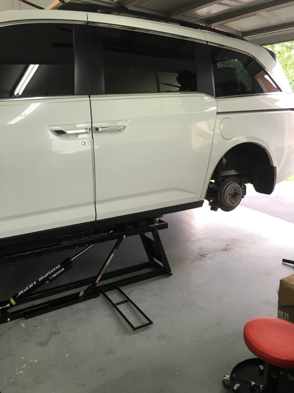

Based on my curiosity, I did several test. Since the wife's car was too wide, I couldn't drive up with the two wheels on one lift so I drove up on the two together in parallel. From a dead drop, no go with car weight. It definitely needs 1 inches of upward movement before lifting vehicle weight. These barely fit underneath my lowered car with an inch or less clearance between the block and lift points and lifted the car with no issues. Name:  image-2025754817.jpg
Size:  455.7 KB Perhaps if anyone needs to drop below the last locking point, they can weld an additional locking bar on the tray.

Problem is, if you weld an new locking point, still no gurantee it can get itself up from there. As they told me, below the first locking point...it starts losing stregnth rapidly.
PS...now put coil overs on and TechArt side skirts and then getting it under there is quite a challenge.

I believe it can. I went pretty low way past the first locks to approximately 6" to dead drop and stopped. Then went back up
