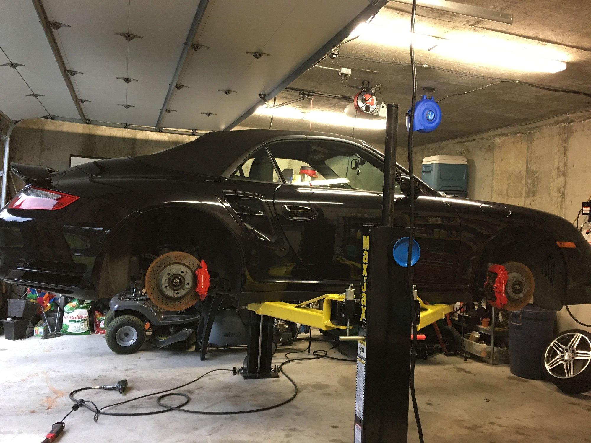

I recently purchased a MaxJax after a lot of research. This issue (low clearance) on our cars was a major deal breaker. Price was in a similar range with a lot more height options. I recently used it to service my car with no problems. I installed the posts 130" apart and made sure I distributed the weight accordingly. It gives me lots of room to work and perform any engine-out services if required. Pics attached. Excuse the mess in my garage - working on a reno for it this summer.

Maxjax is mobile - has wheels attached to each post so you can unbolt from the floor and move them out of the way. Minimum 4" thick concrete required - each post has 5 anchors and each anchor is rated to hold 9000lbs each.

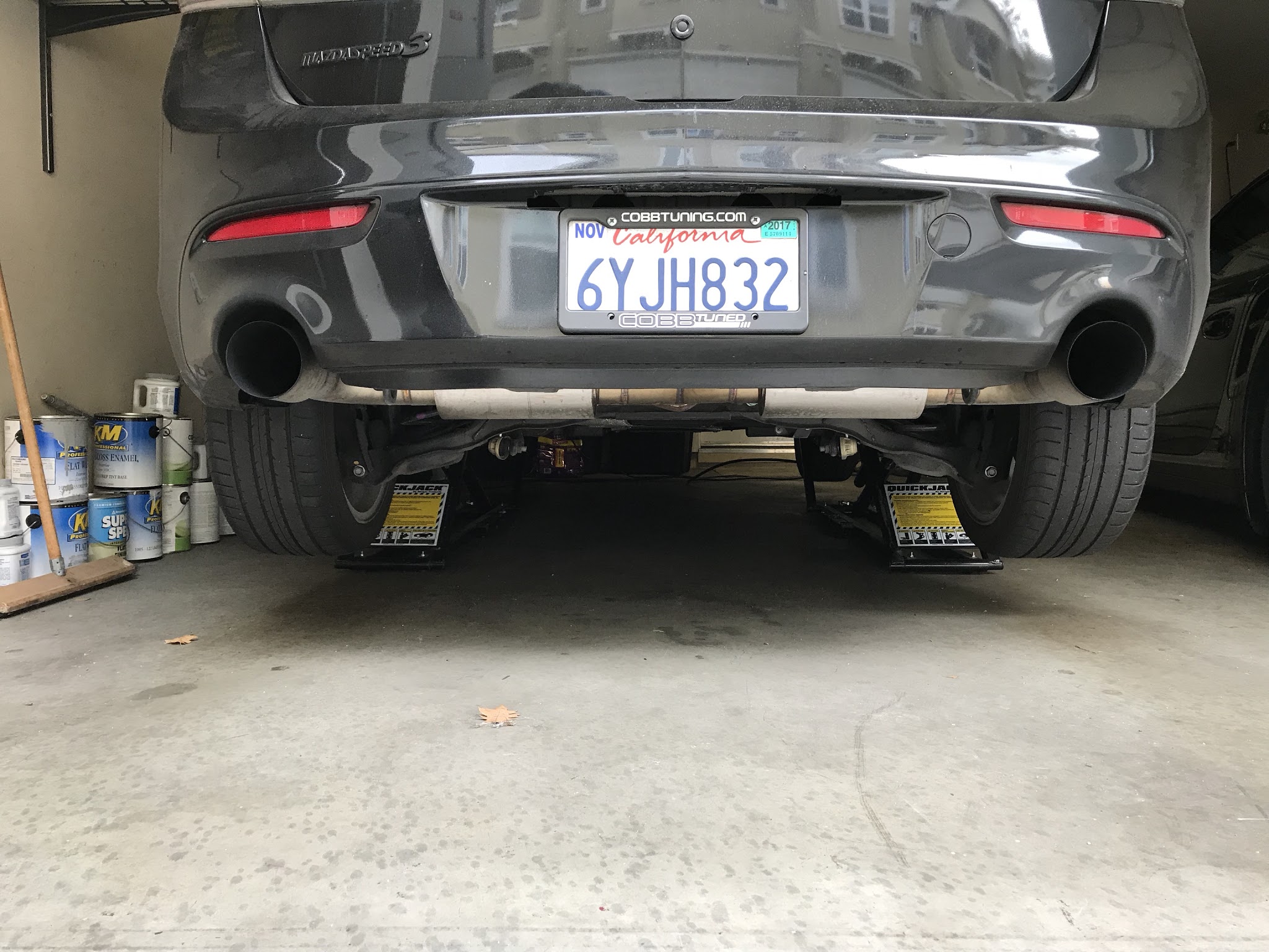

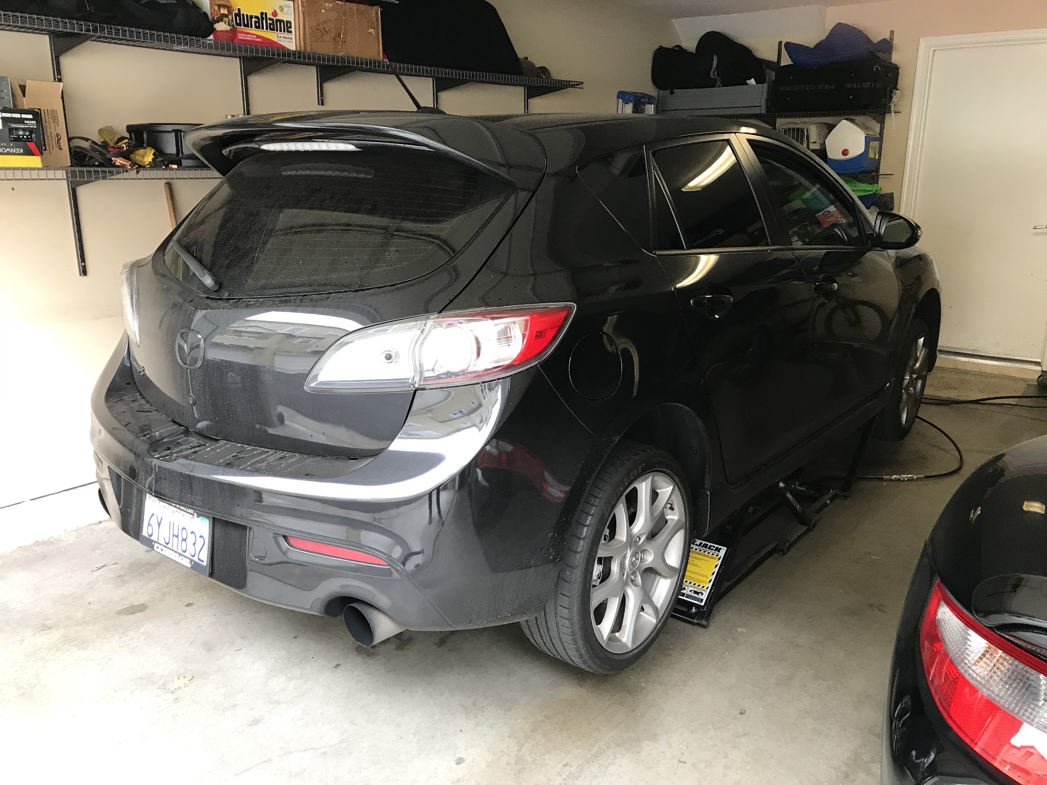

I ended up picking up the Quickjack. He was selling the BL5000-XL and not the SLX. From my research, it seemed as though the only difference with the SLX model is that it had a different locking mechanism. He demo'd it on my Mazdaspeed3 and it worked so I took it.
Unfortunately, he was missing the frame positioning handle, which wasn't a big problem, but I ordered one anyway ($40).
Additionally, he only had 2 of the short rubber blocks. I knew those would be the ones I'd need to use on my Porsche but I continued with the transaction anyway and hope when I tested it at home it'd work with the large blocks. Yep, wasn't going to work, so I just ordered a set of the short rubber blocks ($68).
Here it is working on my Mazdaspeed and I'm hoping it works fine with the Turbo once I get the short blocks in.
