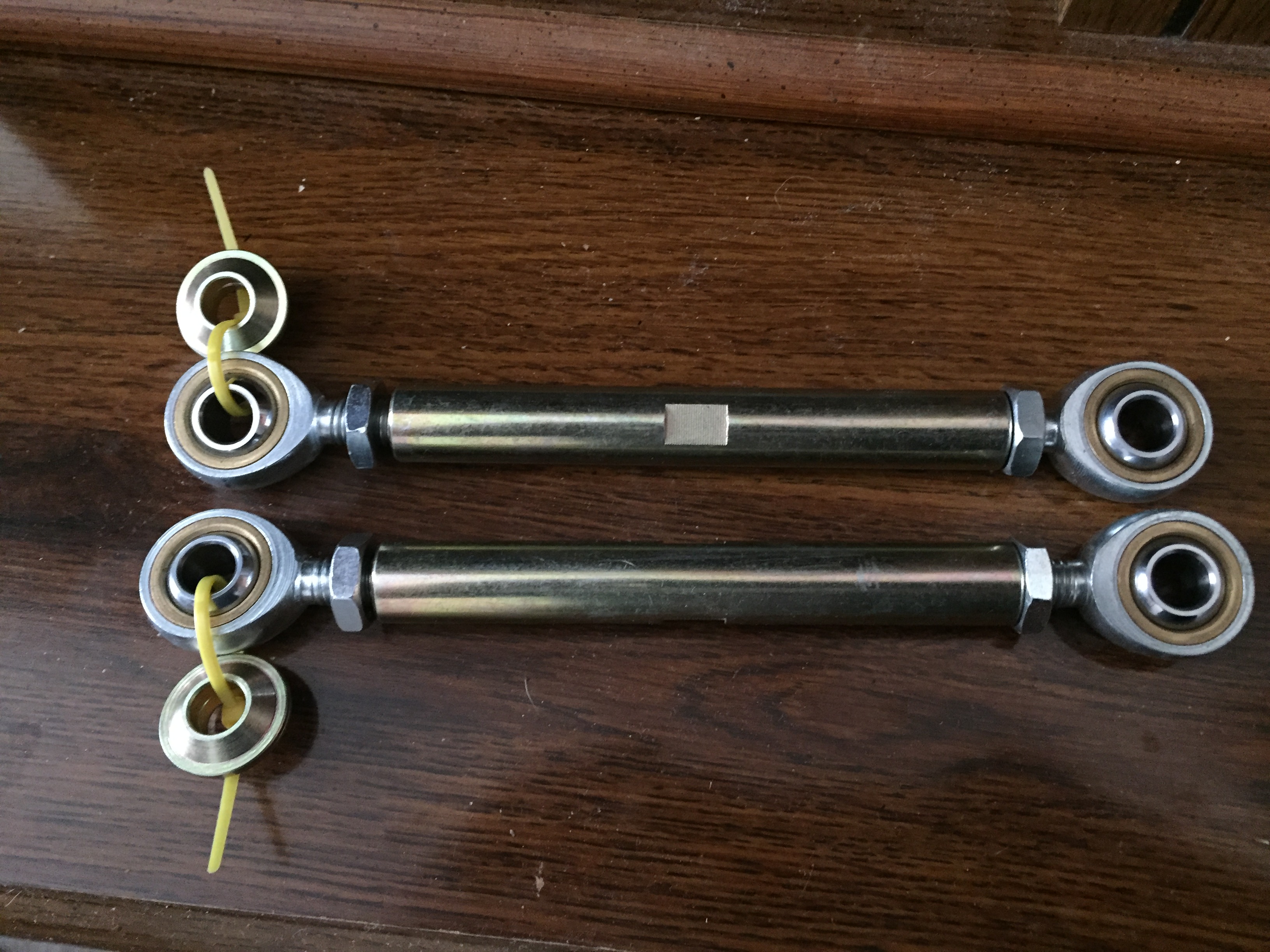

i have a set of rear drop links i made and never used if anyone needs a set
