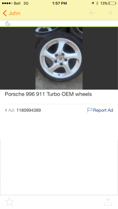

Getting my car back soon from installing Alpha 9 kit and some other mods. Grabbed a set of 996 18" turbo wheels for slicks. Curious what sizes I can run on these for slicks and what tires people have experience with? Car will be dragged race a few times just to see what it does and maybe a light auto cross in future.

What sizes are the wheels? 18x11 rears? 18x8.5 fronts?

I believe fronts are 8" and rears are 11". It's the rims in the pic attached.

You could use Hoosiers in 255 and 315 sizes. That maintains the diameter difference 3% to keep the awd happy. 335 rears will also work, but would be a bit squeezed on the rims. The bfg rival s is also a good option, and it comes in the large 18 sizes. Almost as sticky as the Hoosier a7 but much longer lasting.
