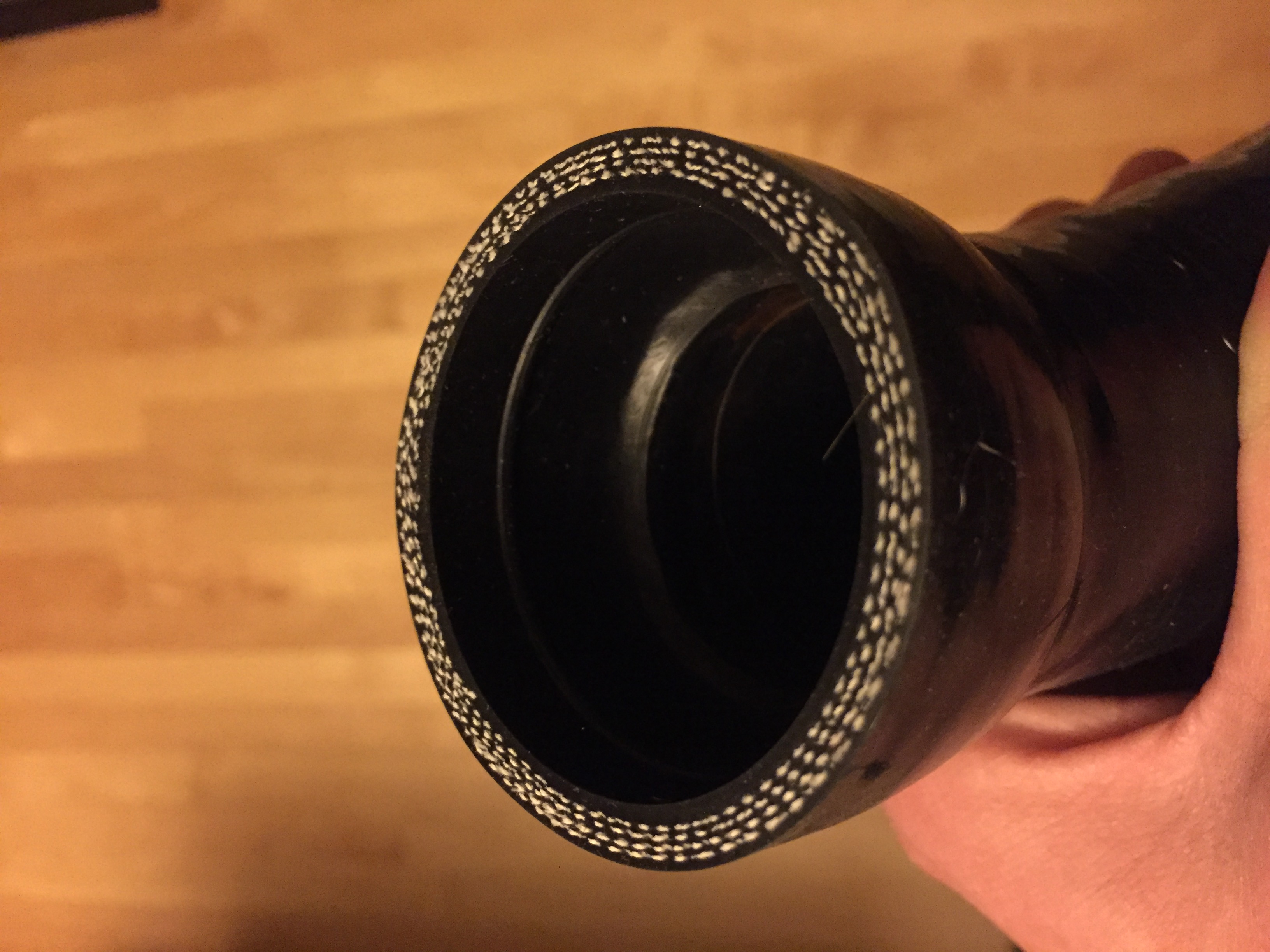

AMS has an update that eliminates the plastic ring. I have not installed mine yet.

No charge. Shoot them an email or give them a call. Make sure to use some t-clamps regardless. Don't use they clamps provided.

Ohh Sorry, No adaptor. Hose is now a smaller diameter with a molded ring/lip inside.

First week of January. Was doing a cat conversion and rings were melted with only a few casual drives.
