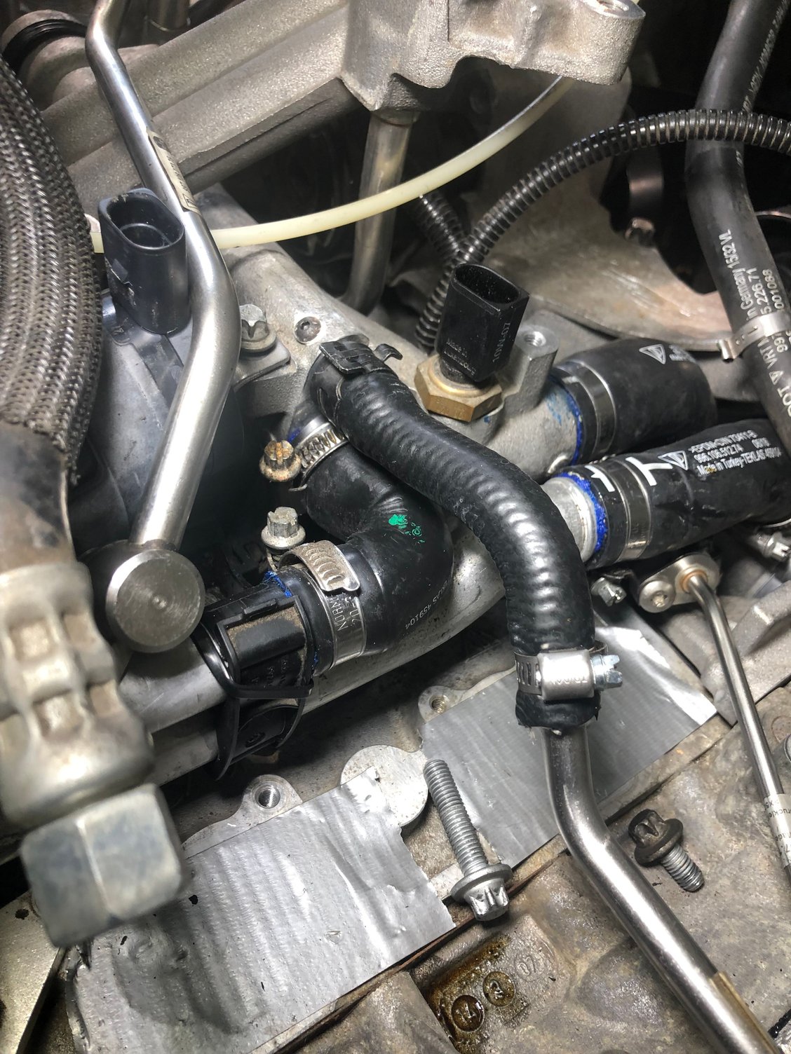

Have you seen the failed line? I am curious since as a vent line there isn't much going on there. The coolant lines for sure are a weak spot. One of them was also not available so I repaired my own:
You can see the rubber section of Cyl 1-3 Turbo coolant feed line has been replaced.
If it's the rubber section of the vent line you may be able to do the same and slice it off and clamp on a similar diameter and bent hose from a local parts store.
If it's the connection to the turbo then I am not sure what your options would be.
Ed

Yeah, you don't weld rubber. I must have missed the welding remark. In that case my idea won't do you much good.
Definitely curious as to what broke. Maybe the fitting to the turbo rusted out or something.
