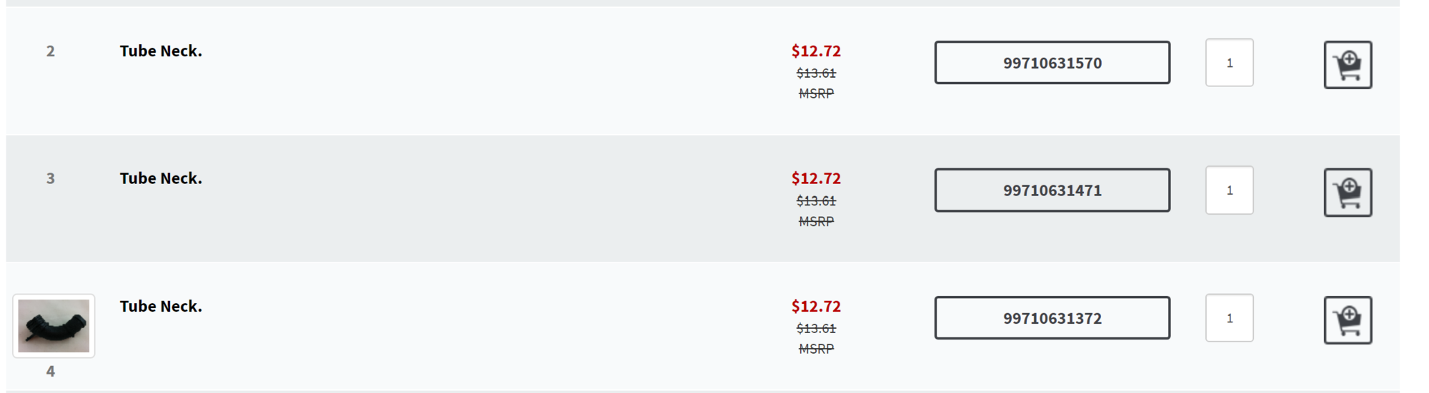

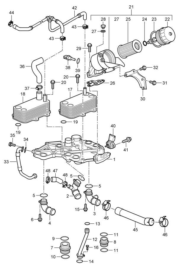

Parts 2, 3 and 4...If you install these parts, you will be doing it again.

Originally Posted by ttboost
Just. buy. these....
Just got them.
These...
Are replaced with these...
These are what get welded (or pinned if that's what you decide)
This post shows how serious and critical these parts are. I'll do the sharkwerks. will leave the pinning and go the porsche route and get those parts with the lines fitted from porsche.
I just wanted to compare with the technician of what is already available at my dealer, if porsche still haven't fixed these. more and more people will start having this problem as it is becoming a more occurrence and probably just a down the road fix for 997.1 GT1s

It's been 13 years...Porsche isn't fixing this...
