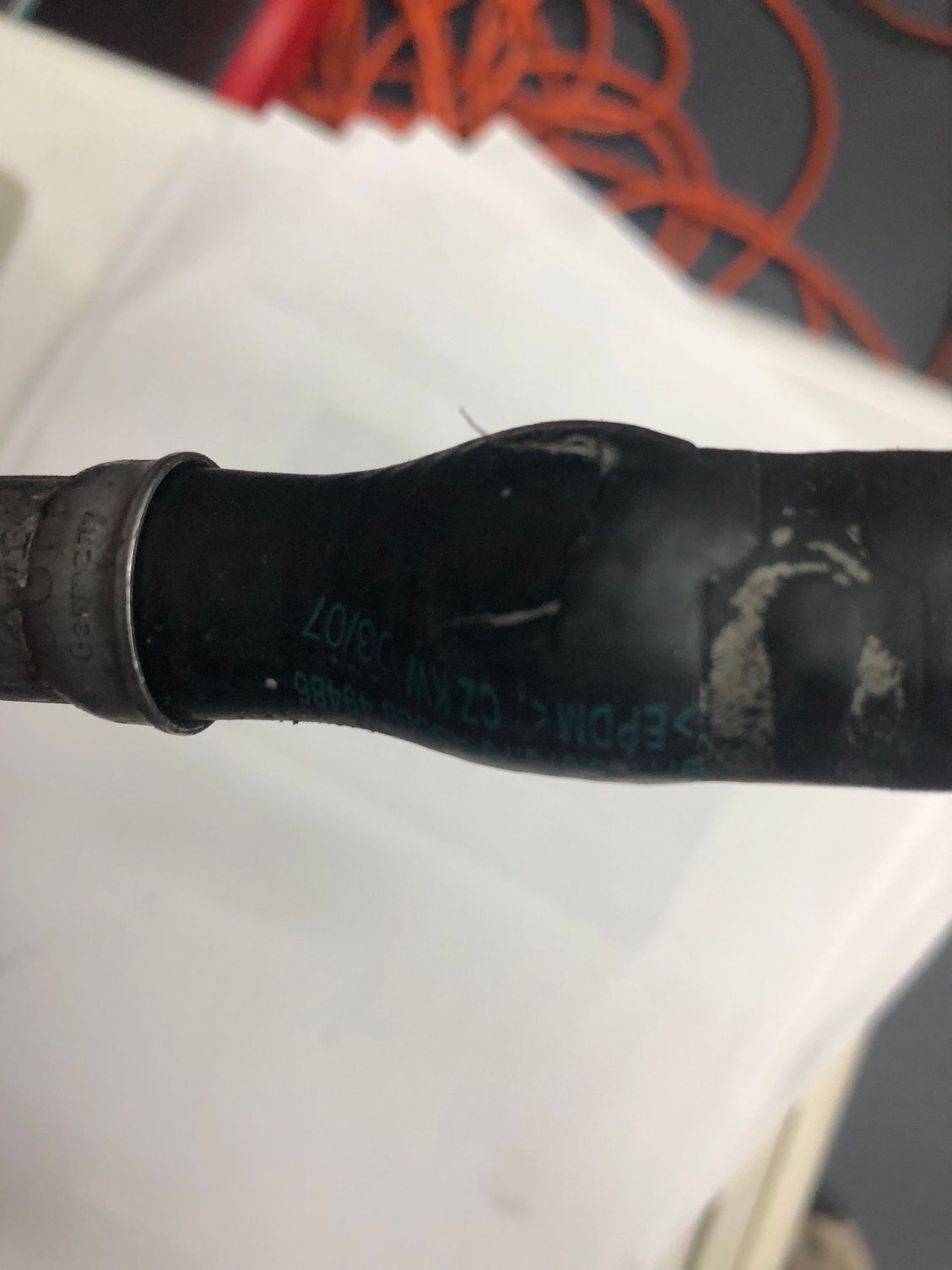

That hose looks new.
Mine was nasty looking:
You can see the thread sticking out from part of the tear. Your pipe does look new and frankly that hose does not look like it was old enough or damaged enough to fail. I wonder if it got cut on install or some other defect allowed it to split like that. The cut does seem oriented like mine and in about the same spot, just without the bulge.

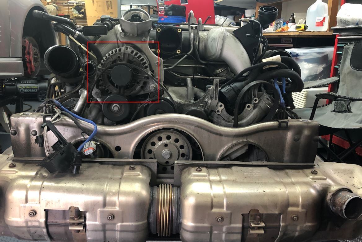

That sounds right. You will still have the IM to deal with, but I think the pipes run between them. I would probably removed the generator to really clear the view there:
That will make pulling the oil console easier. Here is a shot of the driver side and the things in the way:
And what you would see from the side if the SAI and Intake Pipe are off:
So the only thing I would add is pulling the generator and maybe some of the wiring out of the way in addition to what you have.
The line runs between the the rear two IM ducts, but I think you will have access to it from the rear (front?) of the engine once the generator is out of the way.

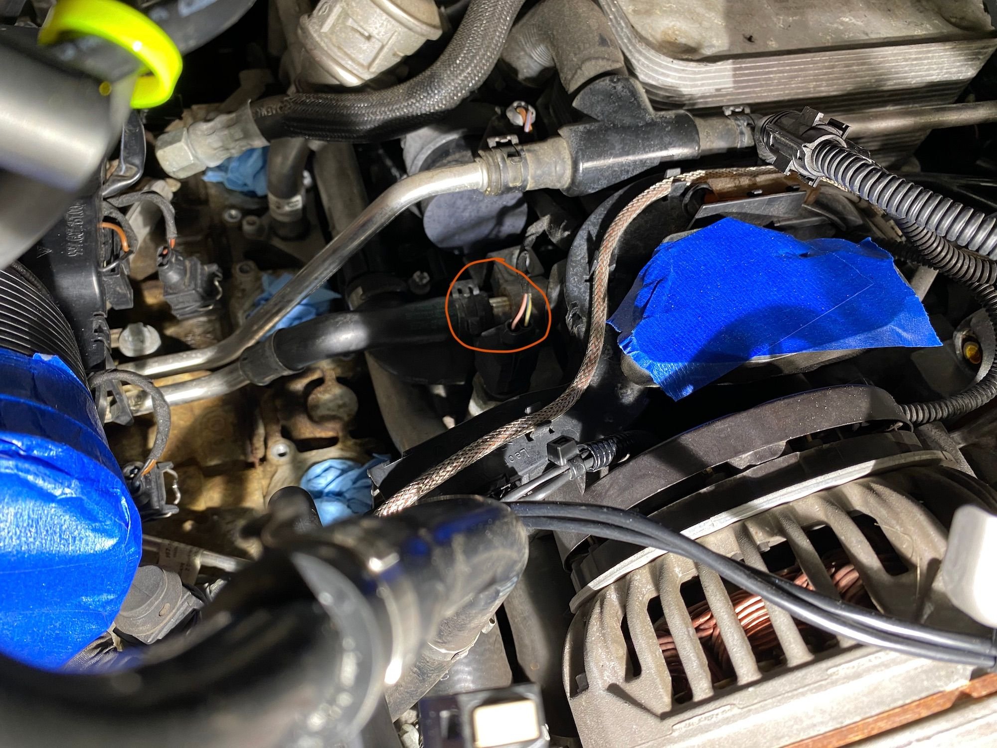

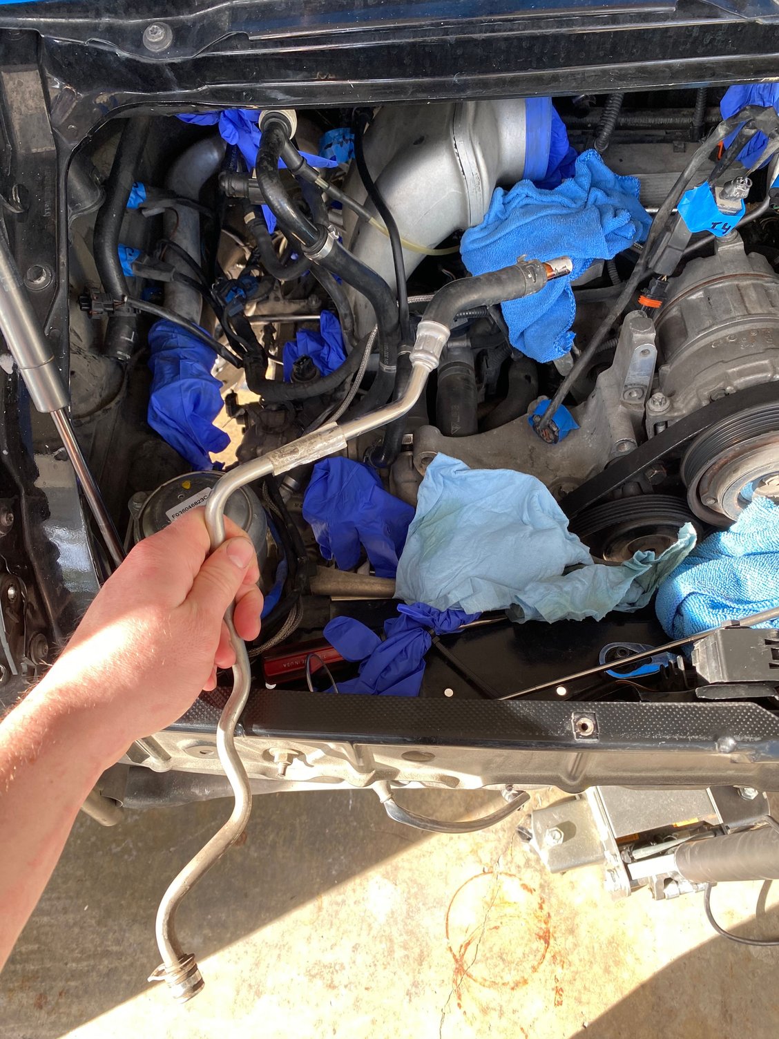

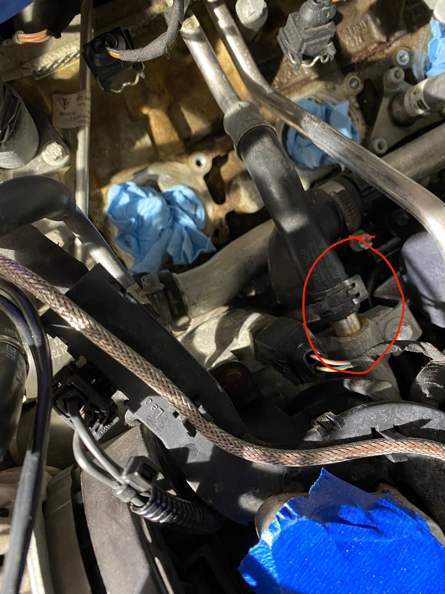

The visibility with the engine outside the car vs inside is night and day. I did get access to the leaking fitting. It's circled in red in the photos. The hose is intact but the fitting is actually loose enough to move slightly by hand. My plan is to take out the fitting, clean/scuff it, JB Weld it back in place and then pin it with a stainless steel screw so it can't back out in the future. I am hesitant to make any more changes. I don't see any other areas I can do preventative pinning with the access I have and I will likely wait until the engine needs to come out for another reason to have the rest of the pinning done. I really hope this is the only source of leaks after all the time I spent!

That's the pipe that started my whole Xona upgrade project, lol. I don't know if the original shop damaged it but they substituted a crappy bit of plastic hose with 2 clamps and that finally blew out a couple of years ago. Then the second shop dropped the engine and we changed EVERY hose...

Supposedly you can pin all the glued connection while the engine is still in the car, but that same fitting fell out in my hand was I was doing my disassembly. The others were solid and fought me on the way out.
I think your judgment is sound. Wait until a drop to do the rest.
