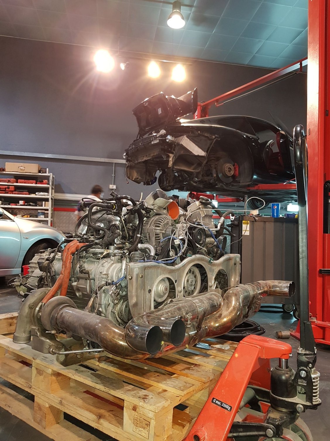

Update - Leaking Injectors
Hello Everyone,
Just an update:
  1. Car wouldn't turn over on the stock ECU with the 850cc map, I'm thinking a lot of changes where made to the engine that I would have needed a retune to get it to start on the old map.
  2. My tuner has looked over everything and made several adjustments with no positive feedback, we decided it's best to finally check the injectors.
  3. Using a Borescope we went through the intake manifold and fed the camera to each cylinder and Viola guess what? Cylinder 2 injector was leaking (Video Below during priming).
  4. Right now I am dropping the engine to remove the injectors and have them tested, The local ID dealer was awesome enough to loan me a set of ID1700x to reduce the down time even though I haven't purchased from them.
My builder told me he had put the 2nd gen ID1700 which should be the ID1700X, will find out soon if that is correct.
I'm hoping the leaking injector is the main source of my problem. Will update again once the engine is back in.

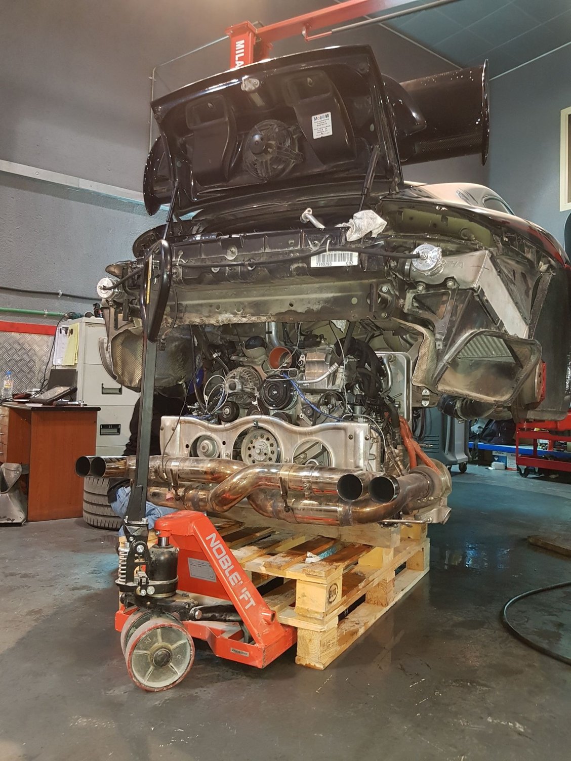

Another Quick Update:
Dropped the engine, pulled out the injectors, they were ID1700X. Atleast we got to visually inspect everything again, it got pretty late so decided to call it a night. Will probably have a more detailed look on everything tommorow before putting the engine back in.
Planning on doing the following before install:
  1. Test the replacement injectors and make sure all is okay
  2. Replace the 2 fuel filters with OEM ones (I am currently running OEM)

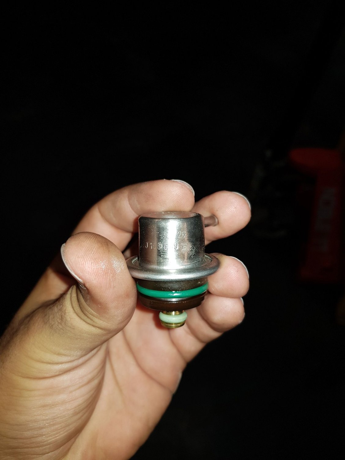

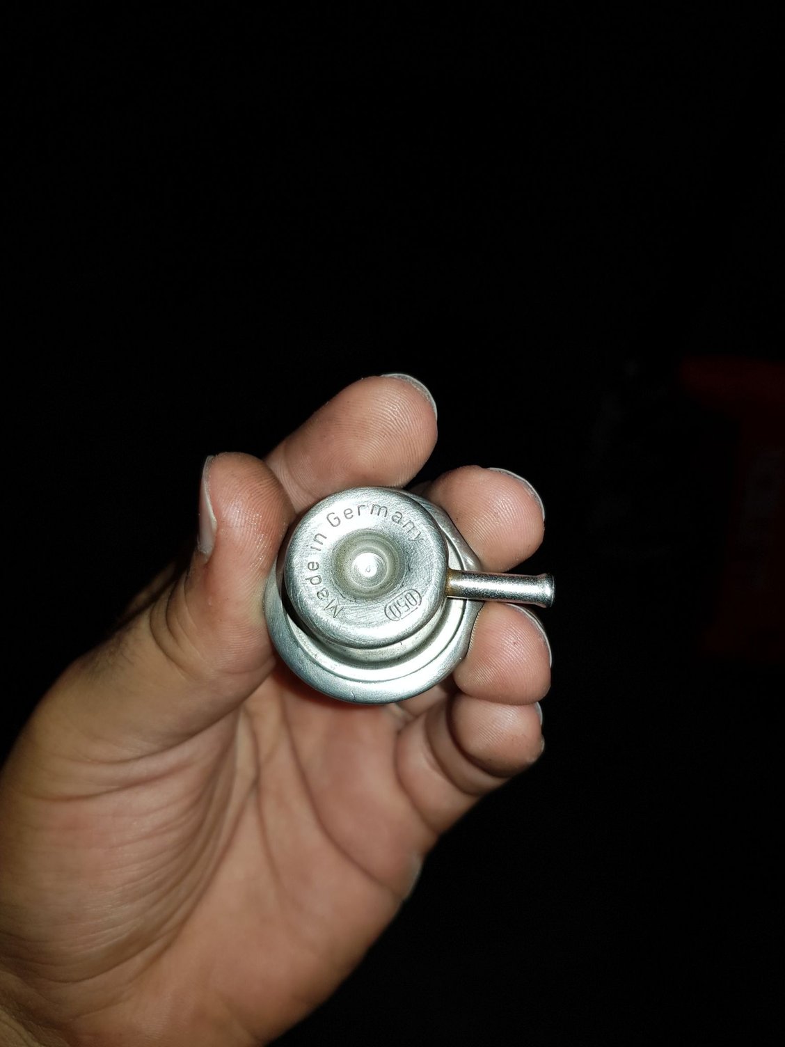

  3. It's not clear if my FPR is rated at 5 Bar or if its a modified 3.8 Bar, I'm thinking of keeping it as is, and if my problem is still there to swap it out later, but will check if it is available locally.
  4. Do an Engine Oil change.
  5. Replace spark plugs as I am sure they would be fouled.
  6. I noticed my breather filter was releasing some oil and was flowing downwards, so will extend it more towards the front to avoid this issue, or at least make cleaning more accessible.
Would appreciate if anyone can add on the things that I should consider changing or inspecting while the engine is out.
Hoping to have the engine back in tomorrow evening with the start up issues out the way.
