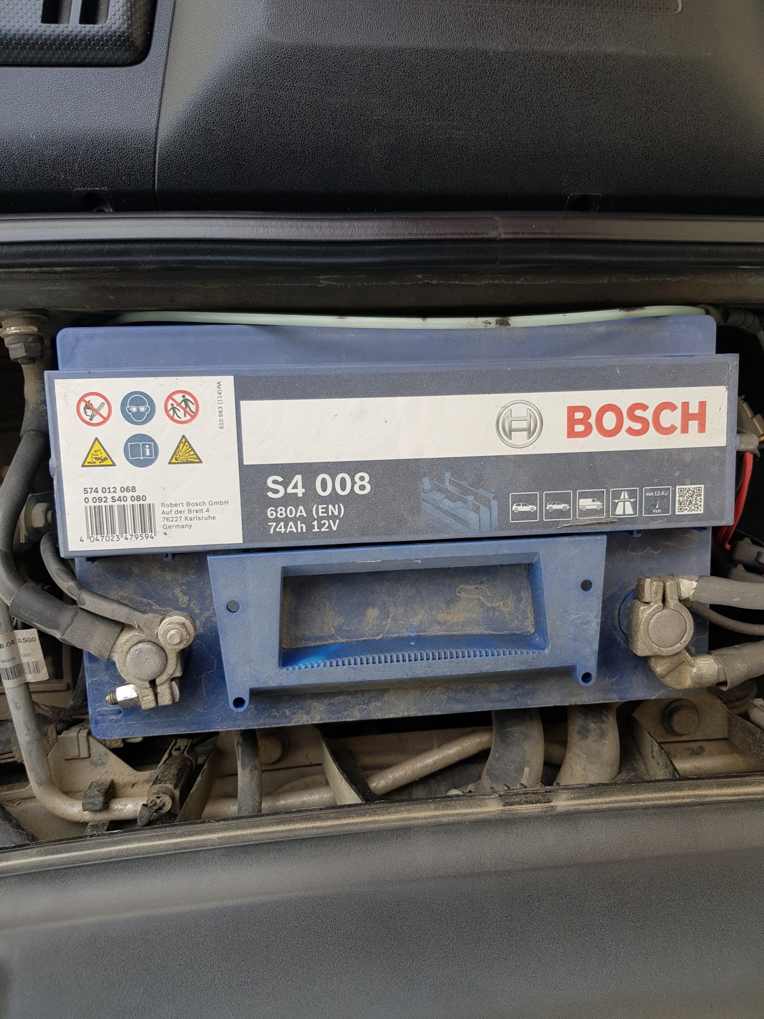

Cranking Amps?:
A friend of mine also mentioned that my battery cranking amps may too low (680A?) he recommended that I use a battery with 800+ cranking Amps? Can someone on here confirm if this could be an issue? Not looking to purchase a new battery when I just purchased one last month. (Battery pic attached)
Note: We checked battery voltage during a bad crank and the voltage was perfect. Start 12.5, during crank 11.5, after start 13.5
