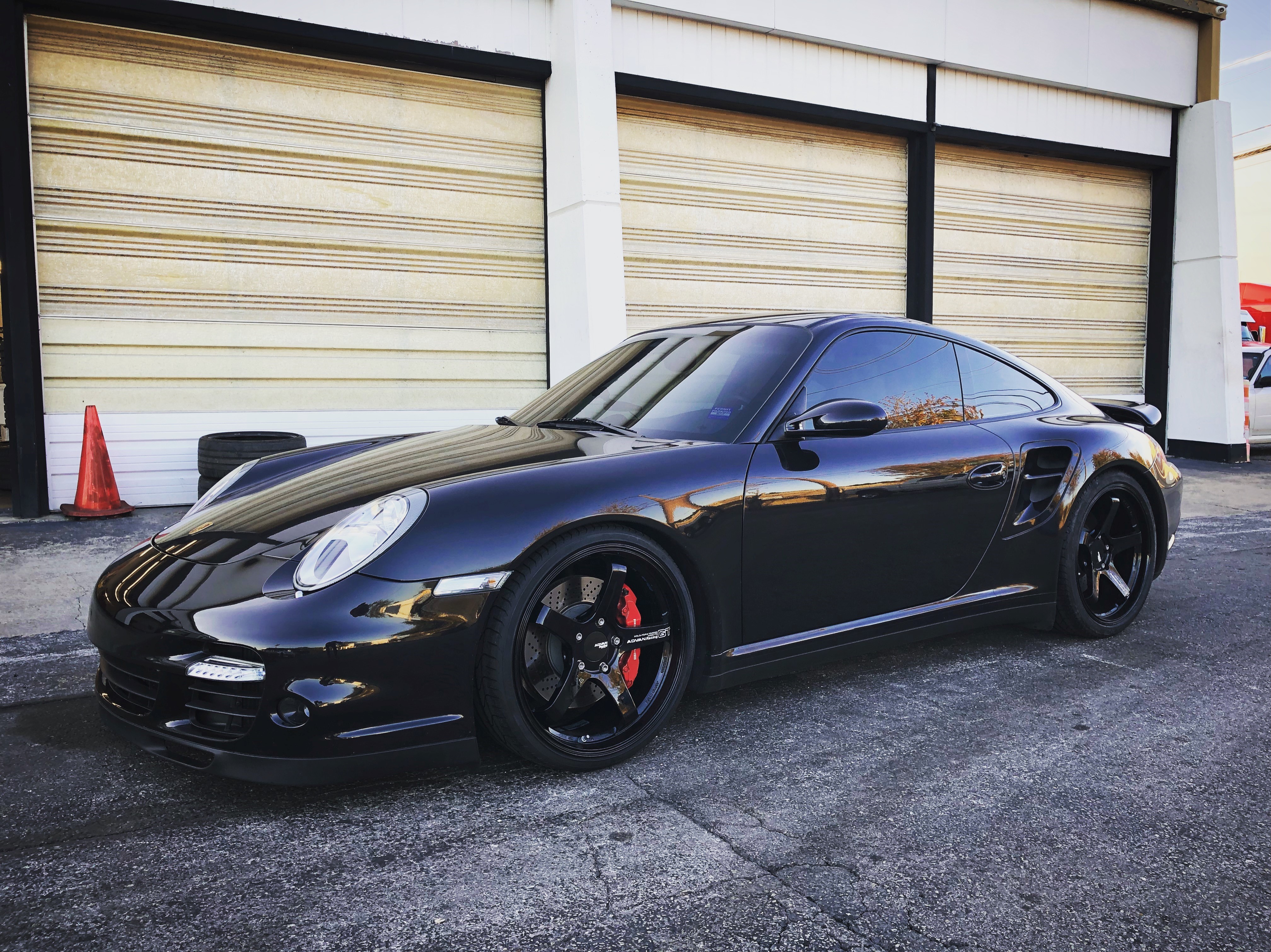

While Sam continues to add more power on VP C10 and I delay taking her to a dyno, here's a little update on the latest addition. Advan GT

Looks awesome my dude! That’s gonna be like another 20 or 30 hp right there!

Beauty, black on black never gets old.

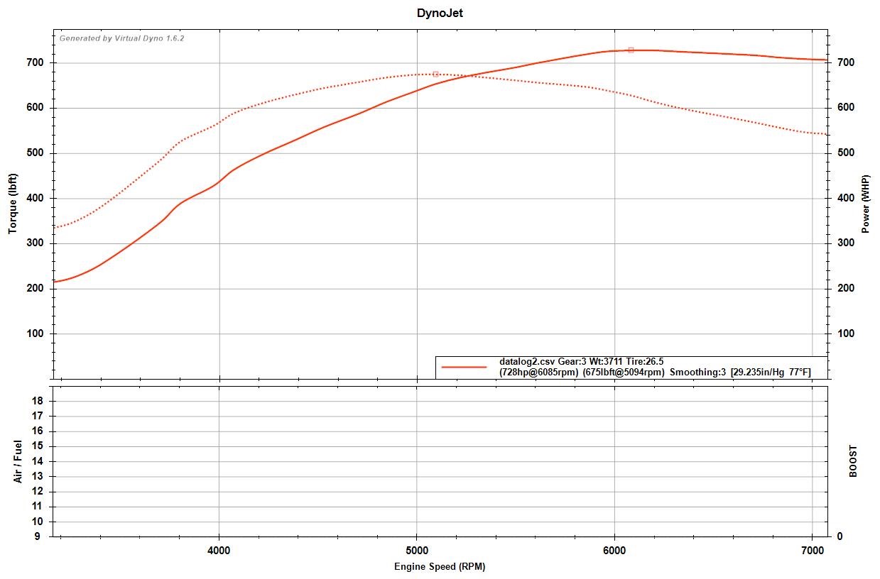

UPDATE: About a month ago we installed ID1300's and swapped the EVOMS intercoolers for Sams Bydesign IC's. I ordered up a safe 93 map for emergency purposes and to ease my fuel anxiety. Had a little trouble along the way with regards to the fuel level sensor calibration which ended up leaving me stranded on a very busy Houston Highway during morning rush hour... (Ran out of fuel while the gauge showed 1/4 tank remaining) A quick recalibration of the sensor and I was good to go. After this exciting moment we switched over to E85. My experience from here has been great besides a leak at the y-pipe/throttle body connection which I eventually remedied by switching to the IPD y-pipe. Constant fine tuning from Sam has helped make what feels like HUGE numbers from E85.
Sam has been playing around with a virtual dyno which has proven to be fairly accurate in recent times(YES I KNOW IT IS NOT A REAL DYNO, BUT IT IS A GOOD COMPARISON WHILE I WAIT). Numbers on this virtual dyno certainly match my butt as this thing is FAST now. TX2K was last week and I of course had to take a quick trip to Mexico to join the festivities... lets just say that it takes some big time power to take down a corn powered beetle... I am attaching my virtual dyno from today with hopes to have some real life dyno results in the next two weeks when I can sneak away to get on the rollers. These are FBO 65m VTG's and E85 we did not test on 93/C10, I am excited to see how accurate this chart is. My experience is an 11/10 still with regards to Sam and his customer service. If you are reading this and still debating taking the leap, you should stop and take it.

do a 60-130 for some real #s
