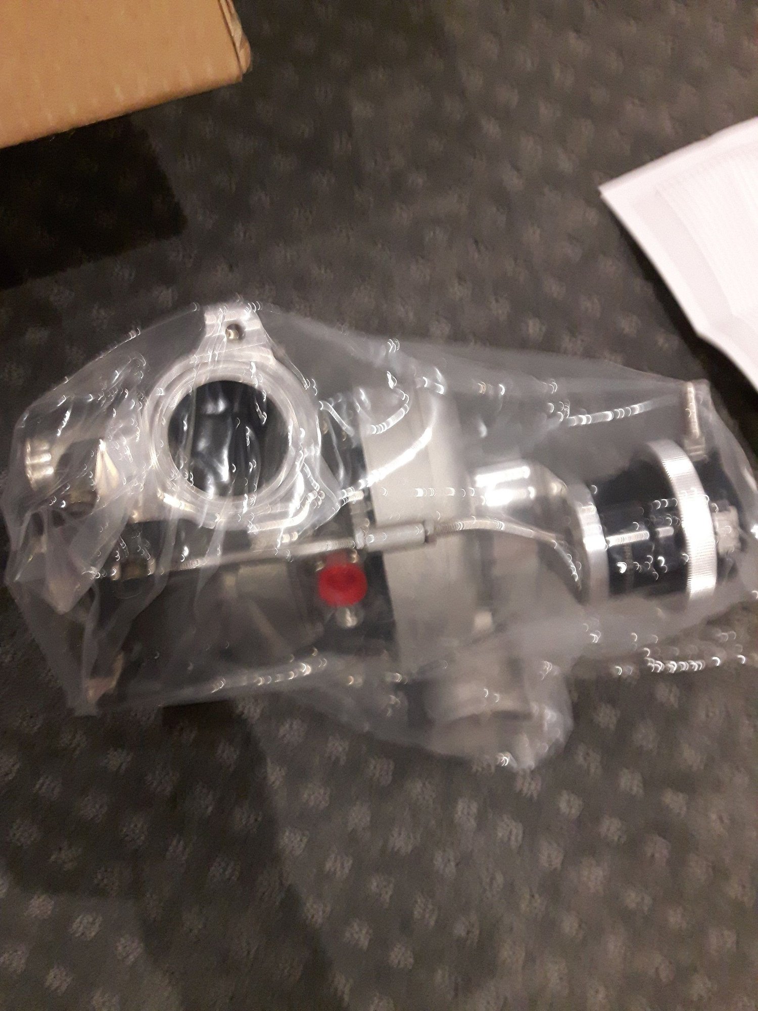

They're heeeeere:
Forgive the crappy initial cellphone pics. More to come....
