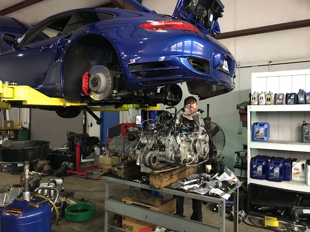

Ready to get my car back. Went ahead and did all the preventative maintenance while I was adding the tune and exhaust. Pinned the pipes, replaced all the hoses......they were leaking through the threads...weird..While pulling one rubber pipe off the whole pipe came out...the glue had failed. Replaced water pump, dealer had replaced one before I bought but it was still leaking. Replaced coil packs, all were cracked, dealer had just replaced plugs and I guess they didn't check these. Put new SRE clutch in from Sam...Thanks for the quick shipping, flywheel had some slight hot spots so we turned it and it looks great, just surface heat. New exhaust from GMG...don't order and then schedule anything until you get their products in hand...slow and poor communication. New coolant tank....better safe than sorry. Had a slight shake in steering wheel when applying brakes, ended up the front rotors were warped, so bought new ones and put those on too. Finally my Softronic tune. The car already had GT3 sways with Tarret drop links and solid motor mounts, so I didn't need to do anything else there. Future upgrades will be: steering wheel, new black front spoiler, present one is painted and not very good besides it gets scratched when I pull out of my driveway anyway, OEM short shifter. One of my turbos had a slight trace of what appeared to be oil, maybe have to do something about that sometime soon, we will see how it does with some regular driving then make a decision. Can't wait to drive it, it will be like my last 09. Here are a couple of pics...I know it dirty had to drive in the rain to the shop.......

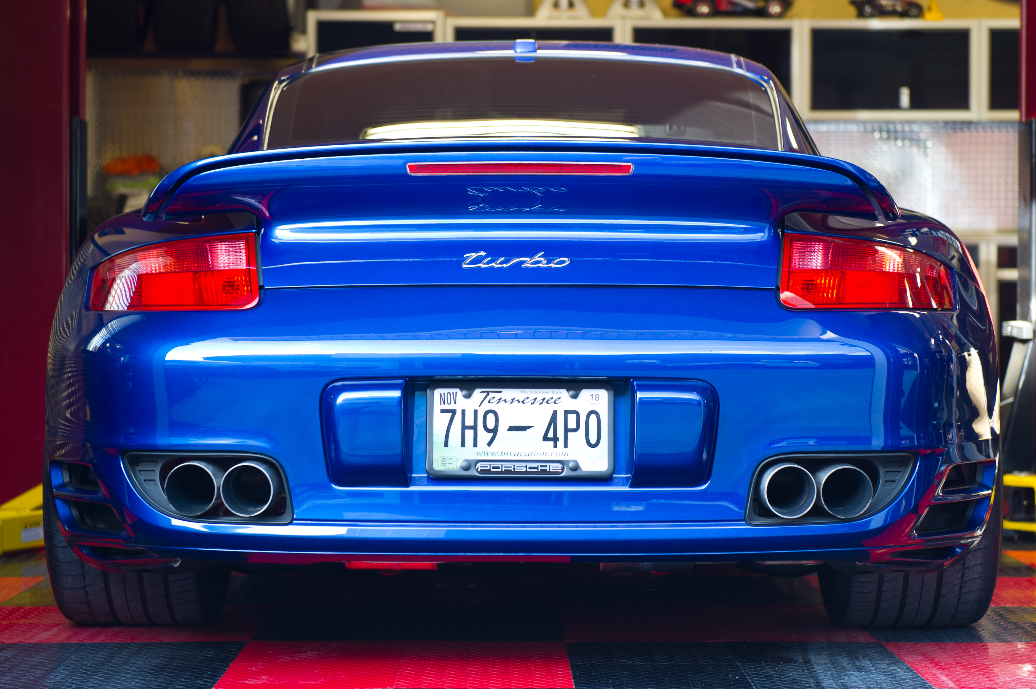

Car is back and running like a champ for just a tune and exhaust. The GMG exhaust sounds great and looks great. Very happy to be back in an 09. There is no doubt that my 16 Turbo S was more refined and plush but not as fun or engaging to drive. Mods as of now are: solid motor mounts, Upgraded 2.5 SRE clutch, Softronic 93 tune, GMG exhaust, GT3 sways with Tarett drop links and all the updated maintenance items.
