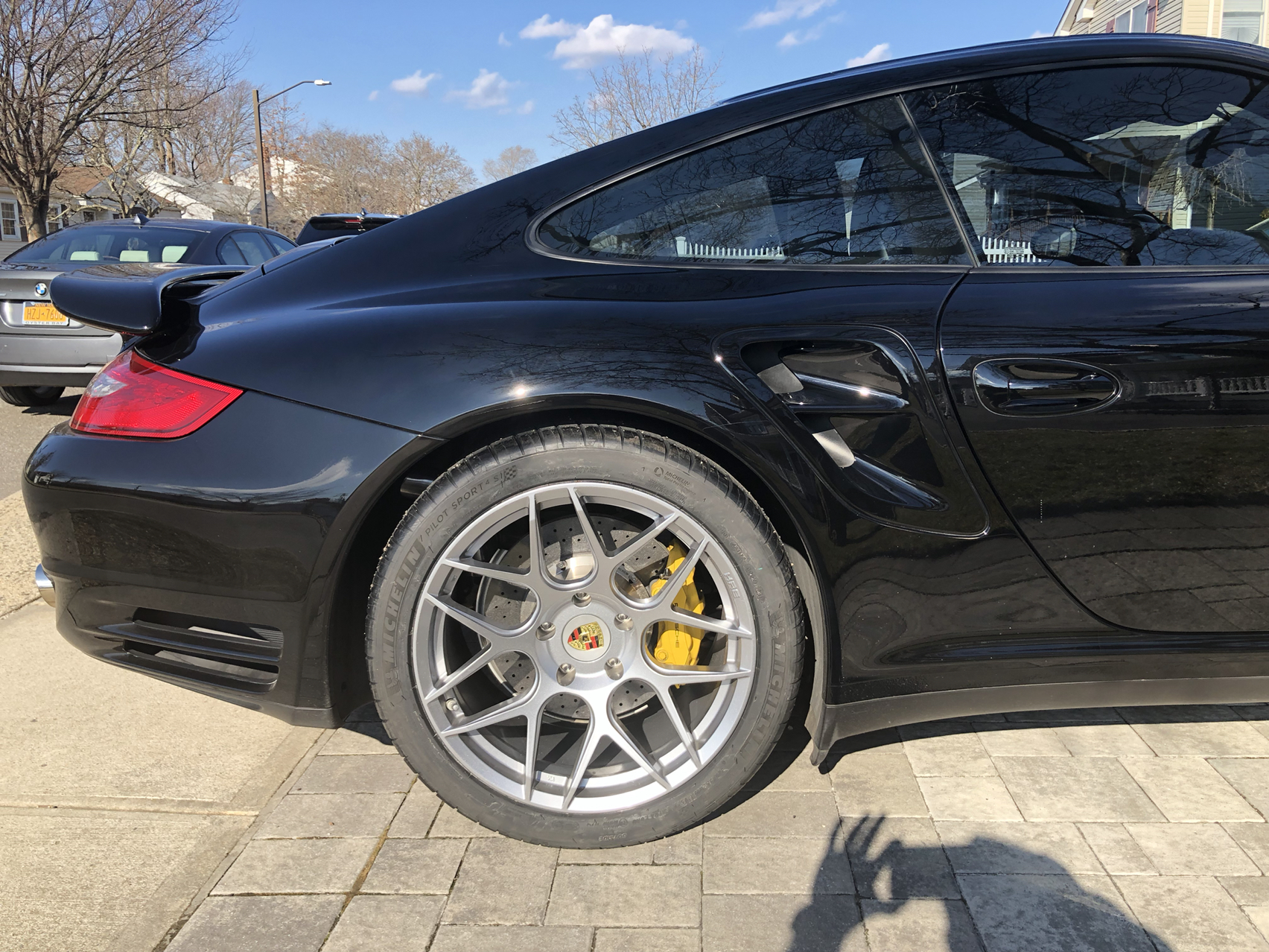

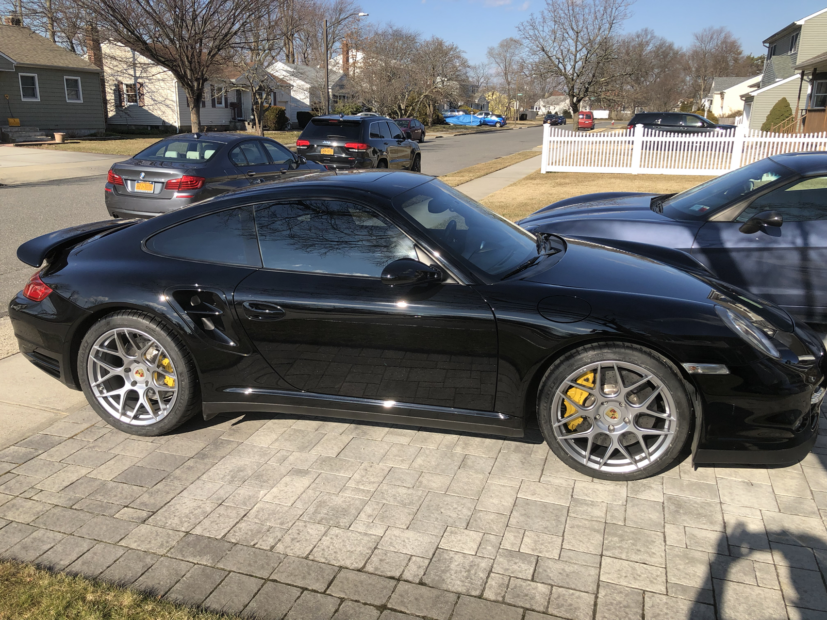

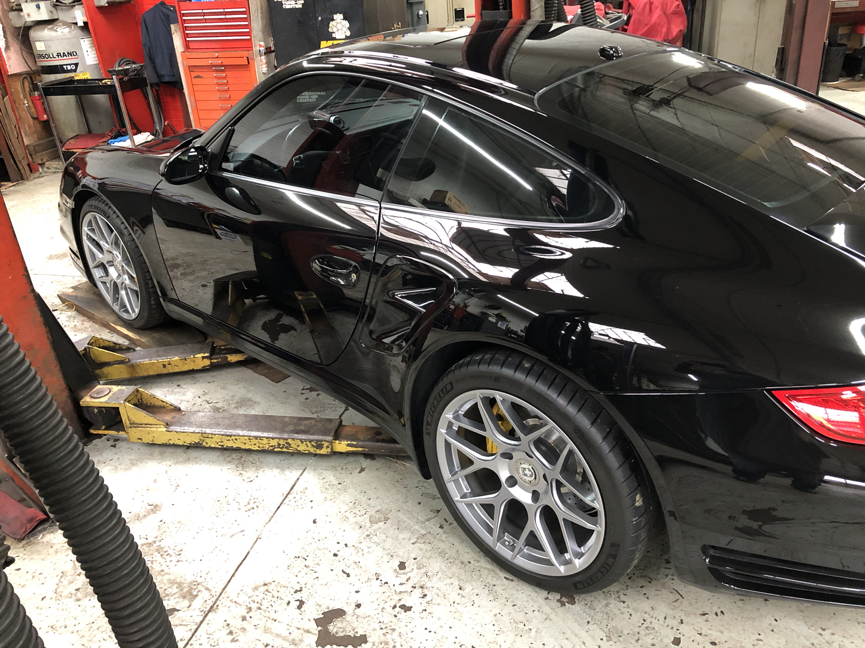

I am running 325/30/19 on 11's and 245/30/19 on 8.5's on FF01's on stock suspension. No issues at all.
