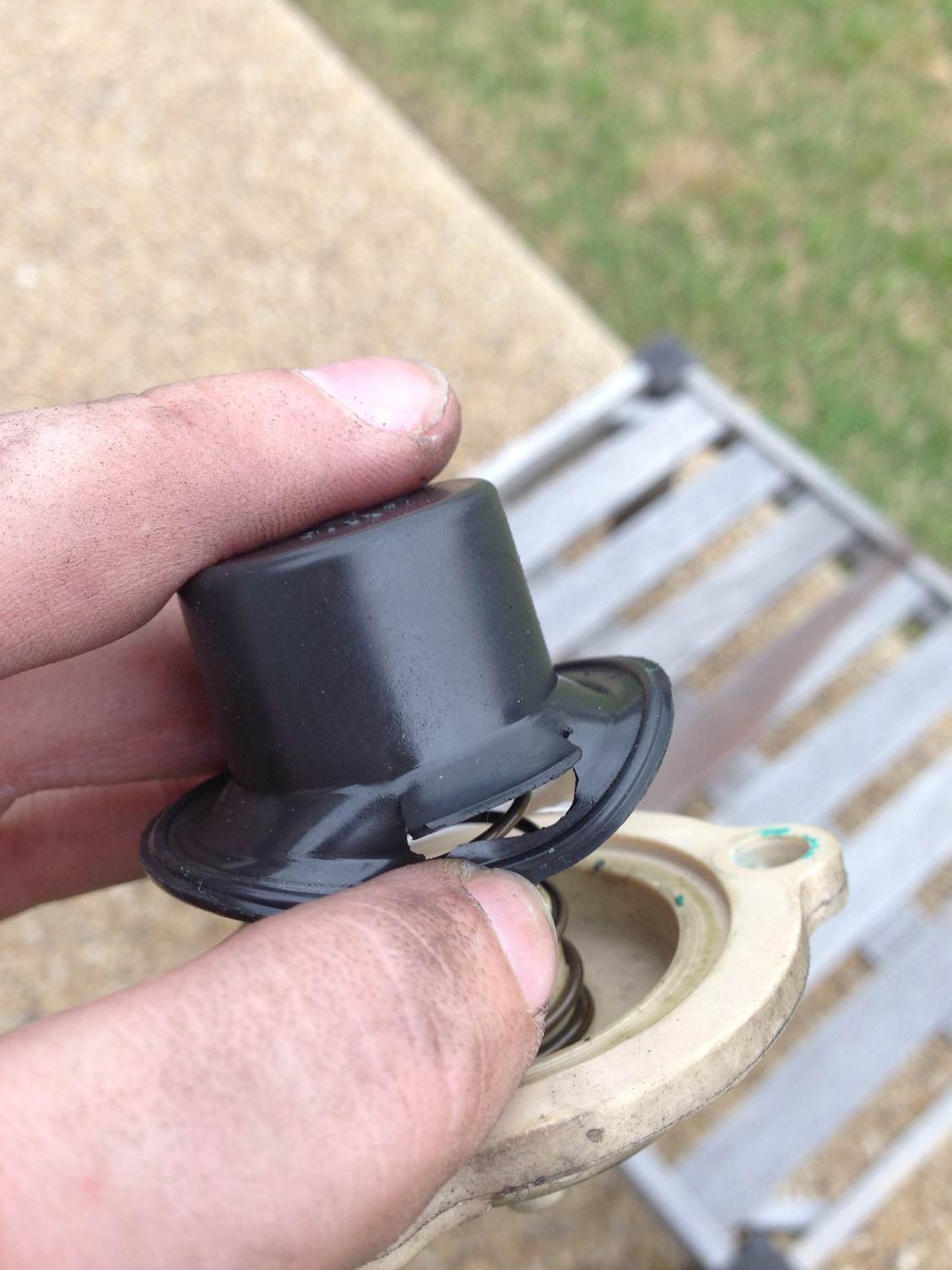

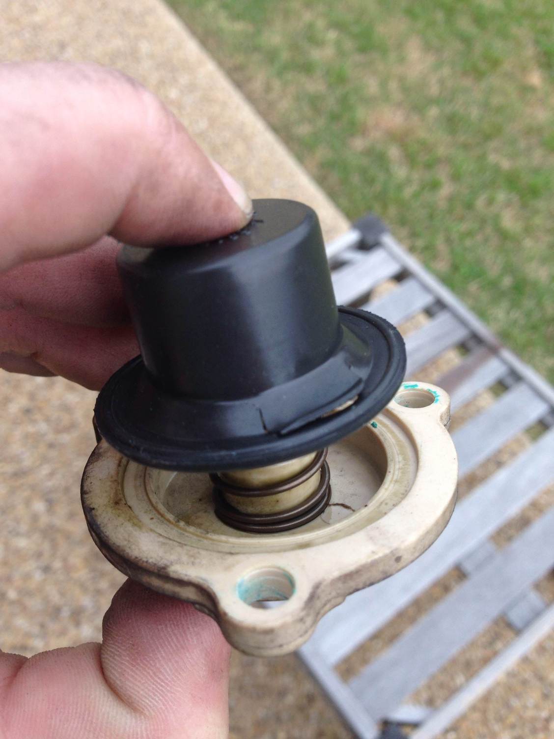

Leaky stock ones look like this;
I replaced mine with Forge as mentioned above, they seem to be the best design of the aftermarket options. It's probably a good idea to lubricate them every now and then though.

Originally Posted by The Bogg
How do you know if there is a problem or leak with the oem brv on a 997.1tt? I.e what symptoms?
There weren't any symptoms on mine. Pulled the two cap head bolts and looked. It was probably minor... But once I knew there was a hole in it I couldn't put it back in.
