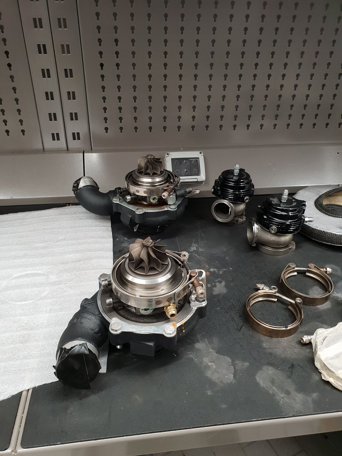

here is my build spec:
* ES1200 4.2L engine: stroker, piston and rods, head studs etc with Motorsports heads and cams
* ESmotor Fuel system: custom intake manifold with 6 port injectors, FlexFuel and in-tank pumps, OEM fuel system still functions as is
* ESmotor Turbo kit: exhaust header and Garret G25-660 turbos. I started with those turbos as I have agreed with Emre @ESMotor that I wanted torque everywhere with minimum lag rather than the most WHP we can extract
* Syvecs S6+ ECU which I am updating to S7+
* Dodson Motorsports Clutches and PDK billet pan and bracing.
* DSS rear axles
I am more than pleased with the results.... although I am only on lower boost level and only on pump gas tune. it is a rocket!!
it is doing 3.7s 100 to 200kmh pulls in our summer hot weather currently... cannot wait for the winter season to crank it up
ESMOTOR and KANOO PERFORMANCE joint project
yes, late nights pulls!! Thanks Emre and ESMOTOR team!
