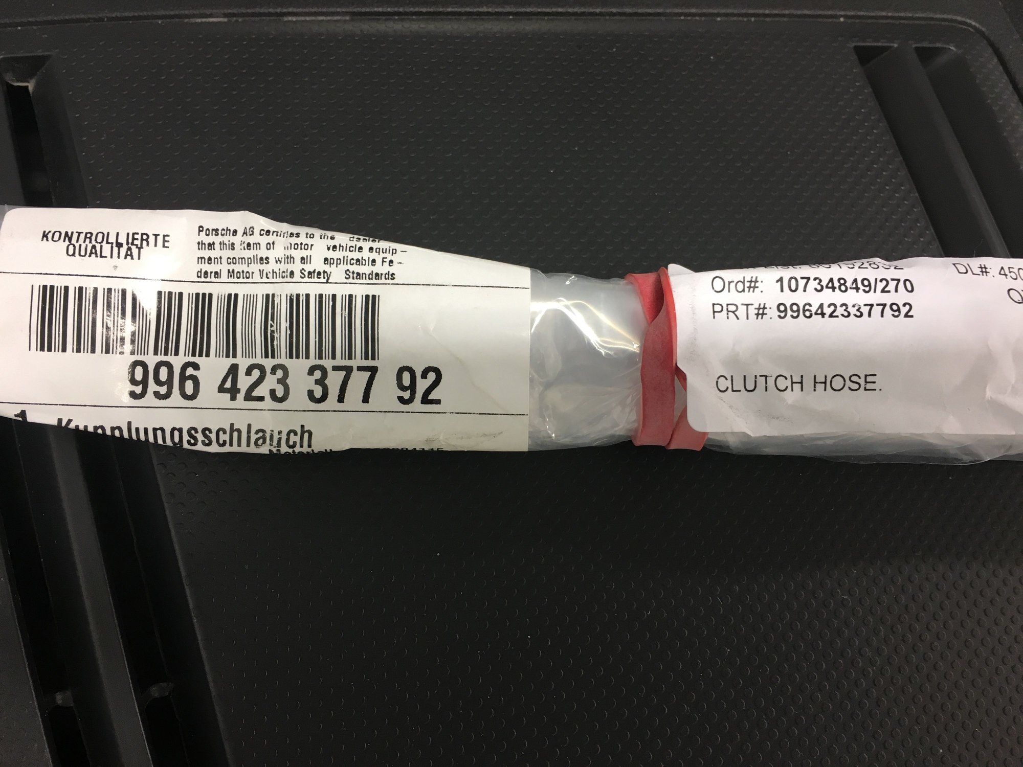

While I have no experience with the BBI unit (I did my own GT2 clutch slave conversion) I used the GT2 line. If it is the same connection on the slave side (and I cannot see why it would not be) the part number is:
996-423-377-92 from Porsche.for about $90. My need for this was that the original line would not have been long enough to make it to the hard line, which "should" mean it will be more than enough for the BBI unit, but you will need to verify that.
For that matter, if the part you are replacing is the original Porsche line you could always just get that (and it may come with that connector already on it). I "think" that par is 996-423-377-54 for about $100 but you have to check with Porsche on that.

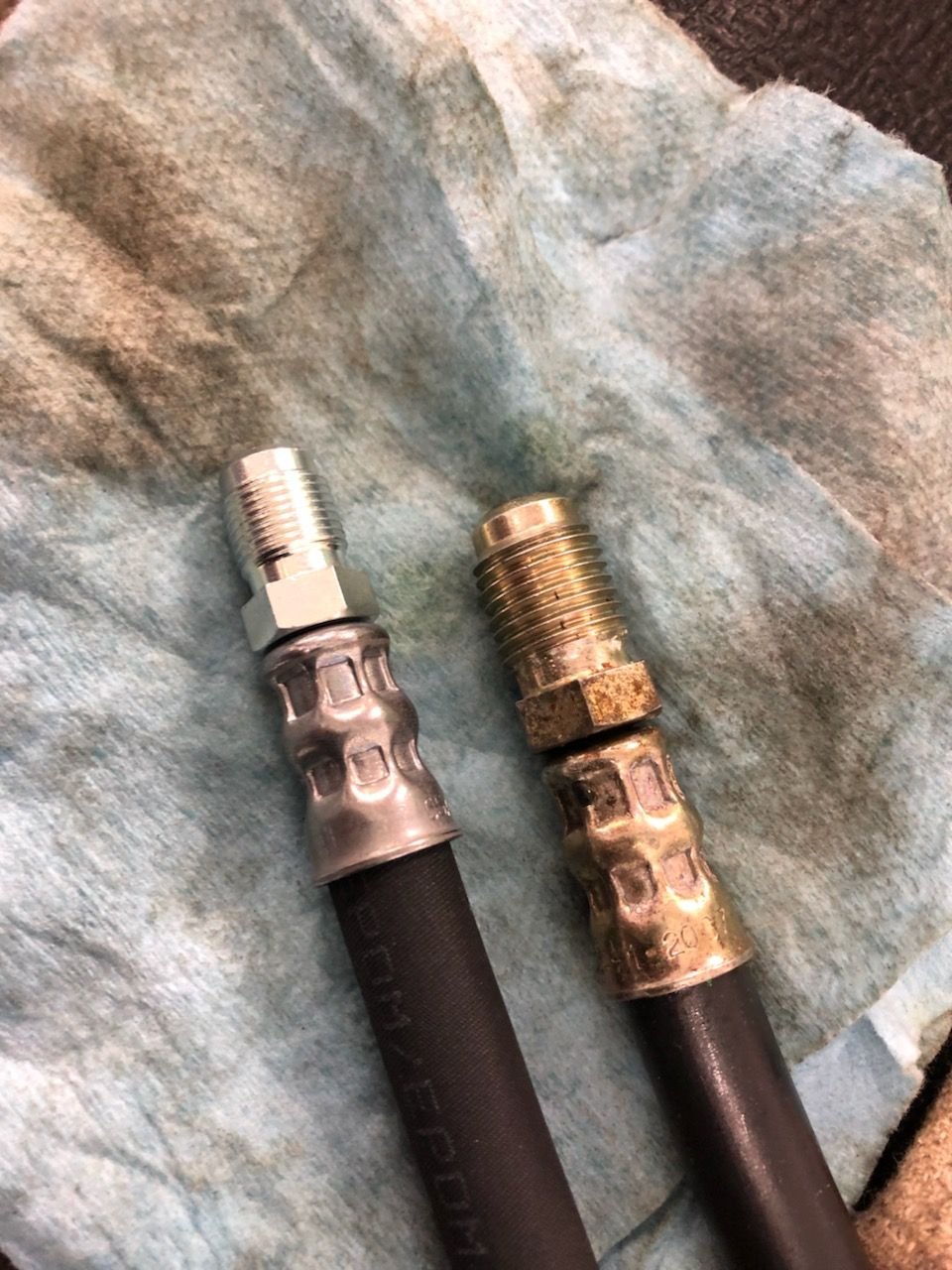

Hi, I did buy the GT2 clutch line but the connections are different.
The OE rubber hose connecting the reservoir also broke down. We replaced a new rubber one but that broke down as well. So in the end we replaced with our own custom DOT 4 brake fluid line.

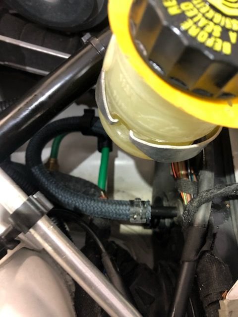

Had the same problems with the rubber lines on my old car with the BBi slave. The slave reservoir to cylinder line nearly totally fell apart when I found it. I replaced it with new hosing that looks strikingly similar to your solution as well.
Did not think the kit was well thought out for the money at all.

I went through exactly the same issues with my BBI slave too. Replaced all the rubber lines the first time they fell apart, and they promptly disintegrated again. For whatever reason they would be fine with normal driving, but would promptly fail when I took the car to the track. Second time it was just an autocross, but still stressed them enough apparently. That second time I ended up replacing the slave hydraulic line with the braided one from EVOMS, but I'm still on the stock reservoir line. Haven't had any problems since, but I also haven't had it back on the track. I hope the braided line will hold up, but I expect the reservoir line will indeed fall apart again—would be interested in the exact parts and steps @NWturbo used to replace it with a DOT4 capable line. Since it's not under pressure I expect it won't fail quite as quickly, but I'm sure it's going to go again too.
Agreed with others that the promise of the BBI unit, a simple swap without having to change other components or do significant labour, appears to be false. Also, they claimed that they weren't aware of others experiencing issues like this unless they didn't properly flush the system of Pentosin (which I did when it was first installed, and again after the lines failed for the first time). From all the identical reports I've seen in threads like this one, it's hard to read that as anything but an outright lie.
