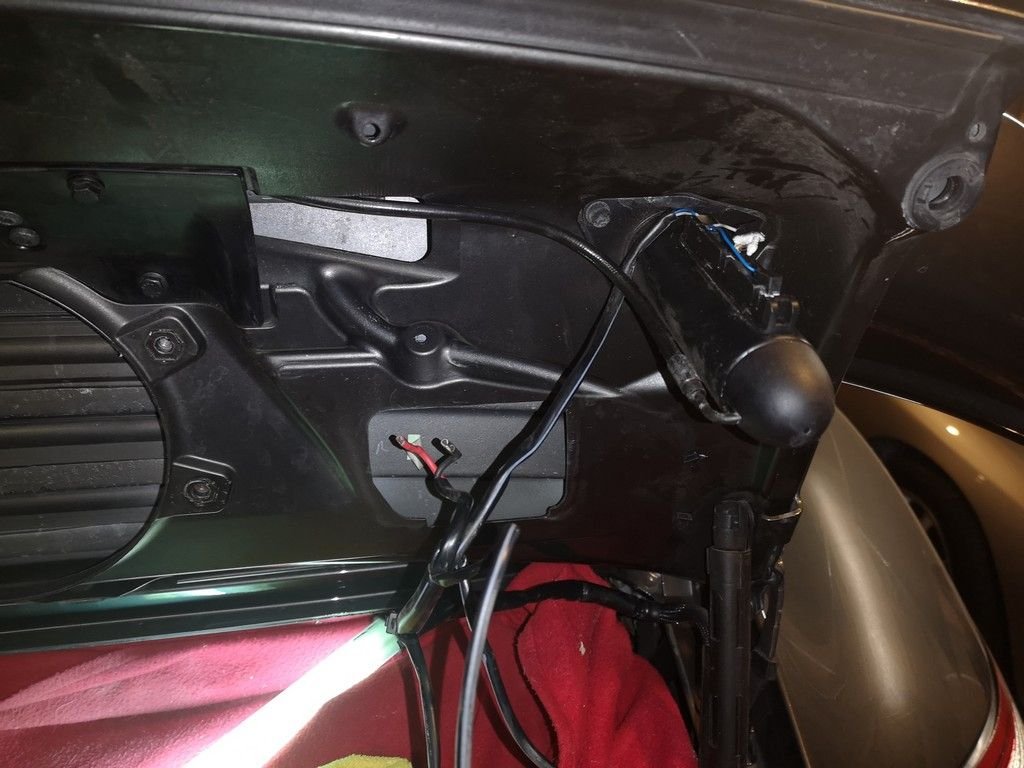

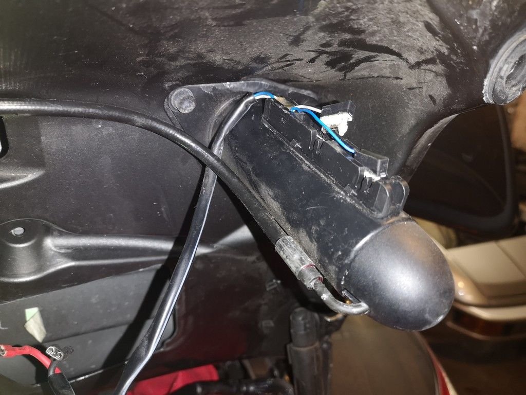

So I am changing out my lid for an aerokit and have made a start to stripping out the lid I have removed the 2 microswitches from the holder however the wiring is still held at the top of the ram does this just lever out as well ?what do you do with these once removed ?

Old Jan 2, 2020 | 01:01 PM
GazC2's Avatar
5 Year Member
Joined: Jun 2016
Posts: 44
From: Scotland
Rep Power: 11
GazC2 is infamous around these parts
Just to add some more info if anyone is removing the wiring the pic below shows how to remove micro switches and wiring loom is disconnected from a plug in the right hand side of the engine bay and the whole loom can be removed,
