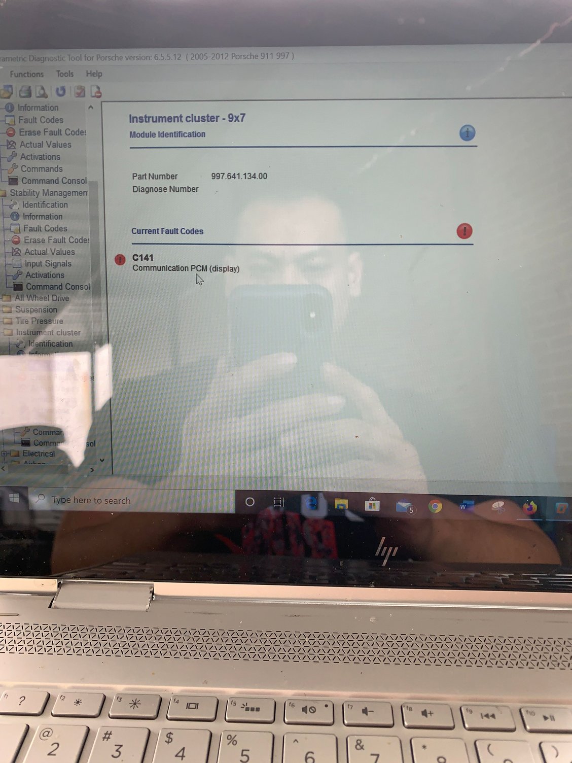

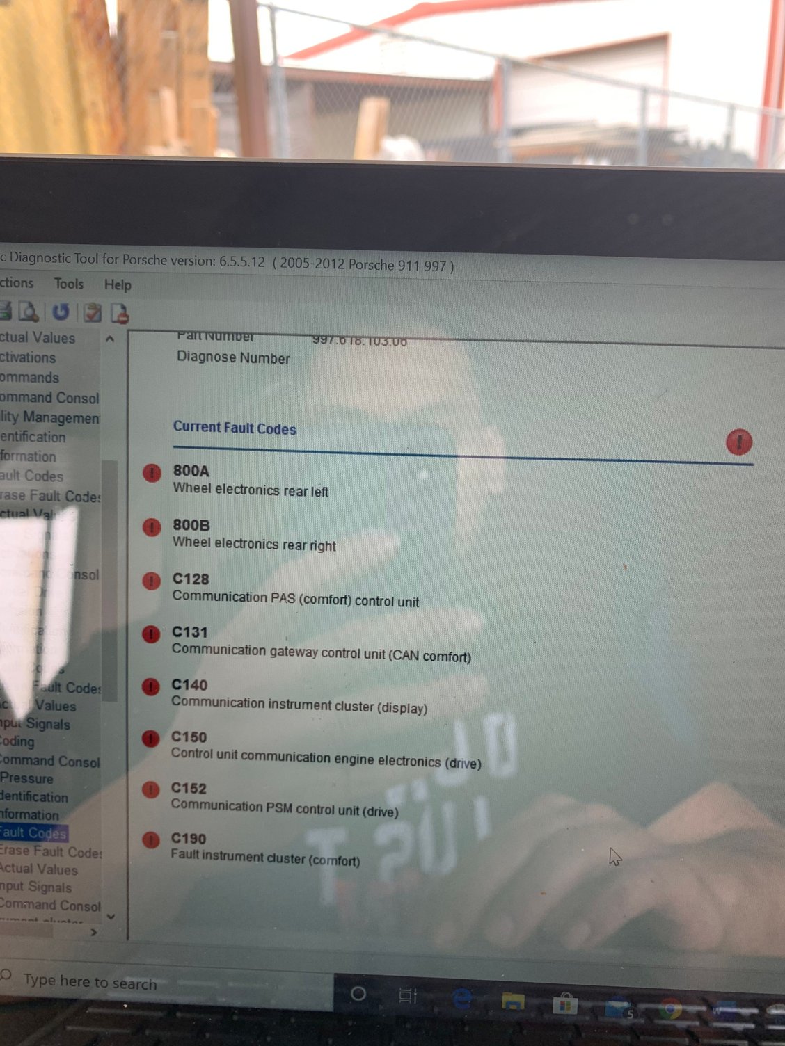

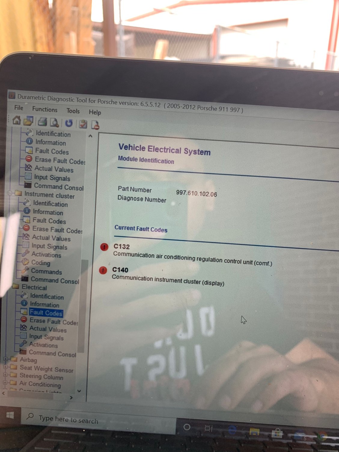

I have an issue. Can’t get durametric pro to communicate with the tiptronic ecu. I pulled the fuse and see if the speedo would reset. Same thing, anyone else know what to do? I had this problem as it doesnt know the car went into park. Had the tip ecu fuse fell out while it was moving from 1 bay to another. Since then the tip ecu doesn’t think the car is in park and I can’t get the cluster to communicate with the tip ecu.

Can it establish a connection with the Durametric to get any reading or does everything error out?

I can get into all but tiptronic.

So sequence of events was:
1. Drive the car and park it placing the transmission in park and "it doesnt know the car went into park" meaning the car rolls freely?
2. Also the information (selection of gears and display of PNRDM and the subsequent gears if you are in manual mode shows nothing, no back lit at all on any of the display positions no matter what spot your select lever is in?
3. After noticing the above you tried to use the Durametric to display what was happening with the TCU, and it failed and when checking the fuse, it just fell out.
Another question: Does the car drive at all anymore? If it does, does it exhibit any problems or unexpected behavior when shifting from one gear to another or is it hard to shift from P to N to D, etc?
