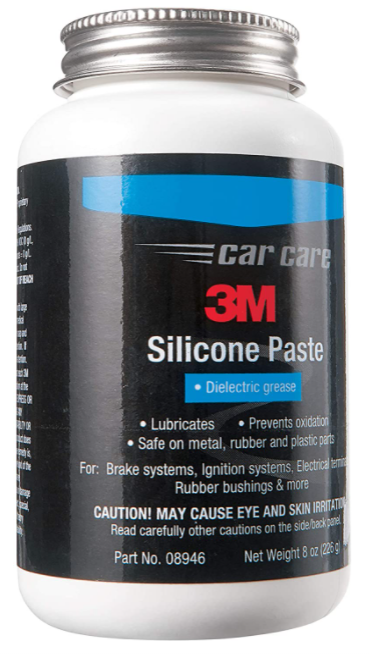

I've ordered a set of upgraded VTGs from Sam and I was planning to install them soon so I can get the cores back quickly. I'm trying to order all the o-rings and gaskets I'll need to do the job from Pelican Parts. Does anyone have a parts list handy? The service manual also mentions something called "Kluber Syntheso Glep" for greasing the o-rings. What is a safe substitute for this?

Not sure if you still need this info or not, but for the o-rings you can use 3M Silicone Paste. Its what I used and highly recommend it. Found at most autoparts or on Amazon.

Thanks for the tip. I actually ended up using vaseline on the o-rings and it worked fine. The job went very smoothly and the results are incredible! These TiAL 68mm VTGs are a no compromise solution...no noticeable lag and tuned to provide all the power the stock internals can handle. I read a lot of posts when researching which upgrade path to take and I got the wrong impression about what the VTG platform can produce. Perhaps 5-8 years ago there was more experimentation going on but Tial can do incredible things with them today. With Sam's tuning I have more power than my goal with a few simple bolt-ons (exhaust, upgraded ICs, intake pipes, 75% meth spray).
