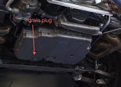

DIY Oil Change, 2010+ DFI 3.8L Turbocharged Engine, M97 9A1
Oil drain plug M18 X 1.5, replace sealing ring, 37 ft/lb
Oil filter cover, replace gasket, 19 ft/lb
Oil volume during oil change 7.5L
Oil volume during new engine build 10.4L
1. Pull out telescopic oil filler tube
2. Clean filler tube with clean cloth
3. Loosen oil filter cover counter clockwise
Once you have the engine bay ready, lift the car appropriately. Either jacks and jack stands, or appropriate gradient ramps with wheel chocks. Once lifted and secured, slide under the rear of your car and proceed with the following steps:
4. Unscrew oil drain plug, hexagon socket - NOTE THIS IS A HEXAGON NOT TORX INSERT, AND THE BOLT IS VERY SOFT (ALUMINUM.) YOU MAY WANT TO SWAP TO STAINLESS STEEL.
5. Drain oil
6. Replace sealing ring
7. After replacing engine oil, replace oil drain plug 37 ft/lb
8. Losen oil filter cover with AF36 (or equivalent) tool.
9. Remove filter cover, remove gasket, pull out filter element.
10. Fit new gasket, replace new filter element.
11. Replace filter and cover into oil filter housing.
12. Hand tighten cover, then torque to 19 ft/lb.
13. Replace engine oil, 7.4L for oil change, 10.4L for engine rebuild/new engine.

Pics added, OP updated and annotated.

Good luck, the instructions I listed above come from Porsche's technical documents. Part numbers are always good - thanks.
Can you remind me what size hex insert/Allen you used? I couldn't remember if it was a 22 or 23mm.
bob
