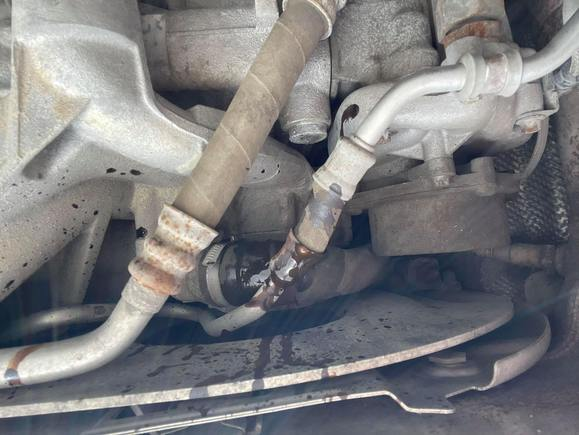

Anyone know which hose this is?
I have a cooling leak near the read of the car on the drivers side. A previous poster posted a picture of it.
it is just above the steel line.
I can't see a part number and do not know where it goes. Porsche told me it's difficult to determine which hose it is based on the shop diagrams.
The earliest appointment I can get is end of June. I want to at least order it before then or do it myself if the other end is accessible.
Thanks for any help.

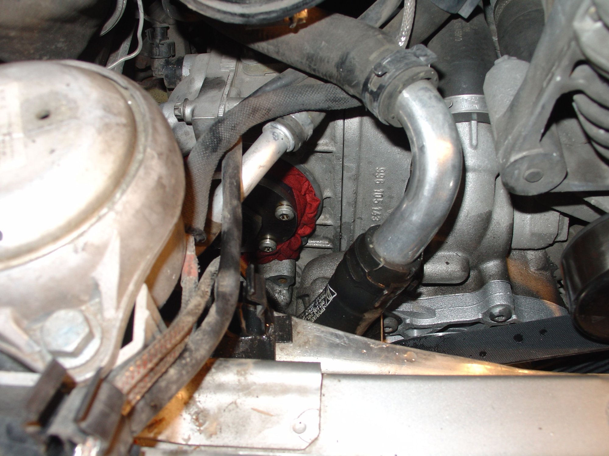

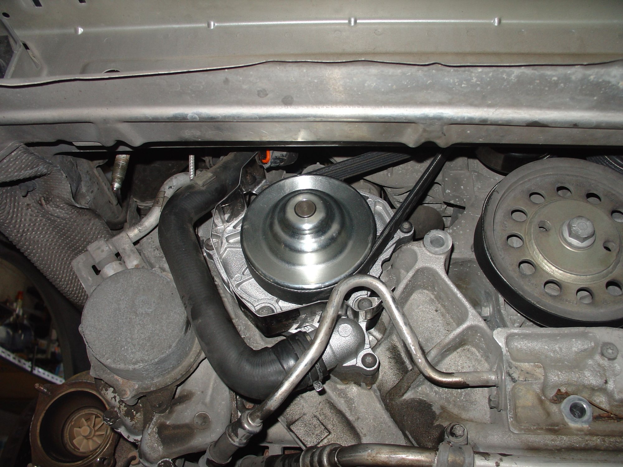

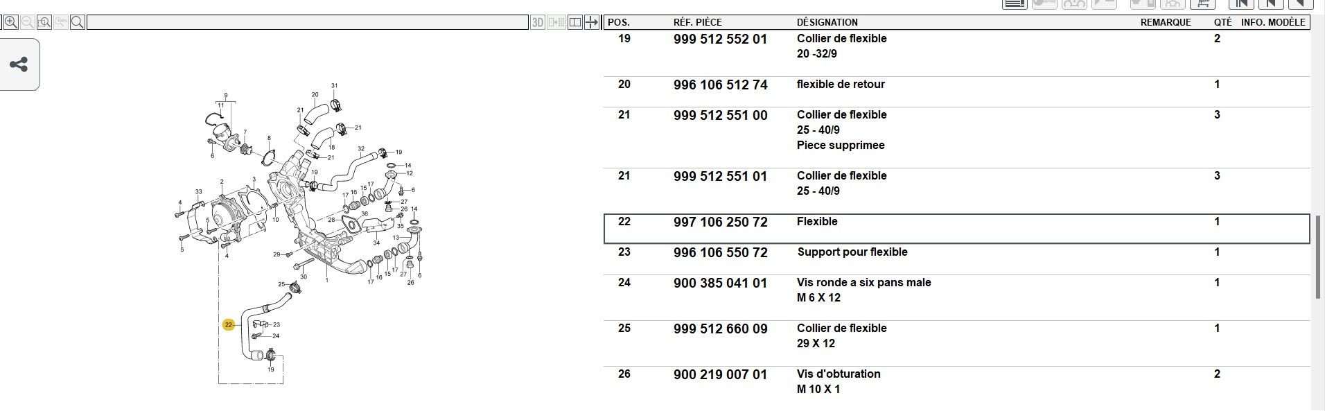

I hope this helps, easy fix, drain the liquid from below, remove the air box, and replace it

Yes , easy, remove the Y pipe, disconnect the hoses and MAF connections from the box, lift it,
it is a 5 minutes job
