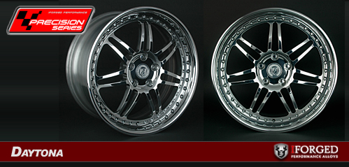

Once I ordered the wheels and waited a while to receive them I have run into quite some problems, one of the main problems is the way this wheel was design it is/will be almost "impossible" to put air on the tire as the "air valve" sits sooo close in level to the bolts around the wheels that you can't get a regular air hose from a gas station to self adapt to the rim. Then, the way the wheel was made you have to do some modifications in order to fit the "tire monitoring sensor" from the 997TT.
It's been quite a BIG pain in the neck and still in the works to make the wheel work for my application, anyone else had any experience in regards to this? here's a pic but you can't appreciate to view the wheel enough.

can you get a longer valve? Might look ugly though.
Tire monitoring equipment would be car specific so you cant really fault them there unless they market them as compatible. When I ordered BBS wheels I was asked if the vehicle had a TPMS so I assume they sent me specific parts.

The air valve at my Cargraphic also located at one of the bolt. You can see at my pic. My rear with 3.5" lips, normal gas stations air hose was impossible directly plug to the valve. My wheels come it a 2" value extension. Just screw it on the valve and it will work perfect. I think you can ask iforged or any wheels shop for it for less than $10.
