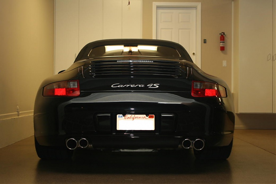

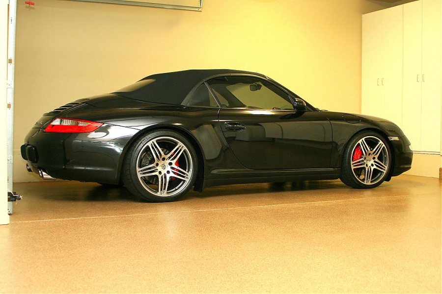

Detailed C4S Cab on a new epoxy floor
SubscribeI recently had Premier Garage finish off my garage floor and felt it would be a shame to put my car back in without a detail of its own. There's nothing like the rear of a C4S. Well, almost nothing!
Nice job on the floor and on the car.
Do you know if they sanded the floor or used muriatic acid to etch it?
The reaon I ask is once my car is done it is the next thing on my to-do list !

Premier Garage sanded the floors to prepare the surface. Good luck with your project.Originally Posted by justatoy

I had my garage floor done by Premier Garage 1 1/2 years ago. Best money spent. Muriatic acid etching is NOT done in the process. Only sanding down to the bare concrete, followed by bonding the cracks with "bondo" used in auto repair shops. A primary coat of polyurethane is put down evenly, followed by spreading of paint flecks onto the primary coat. Floor is then allowed to dry overnite, followed by scraping all the flecks not absorbed by the primary coat. Entire garage is then vacuumed thoroughly followed by a final clear coat that seals the floor and gives a satin sheen. Only one coat is given on final coat so as not to make the floor slippery when wet or dry. Finished product resembles a terrazo floor in a new high-end home. Maintenance is nearly 0. Just hoze off or wet mop with mild vinegar/water or ammonia solution. I use TSP (tri-sodium phosphate) highly diluted (3 pinches in 2 gal. of COLD water). Once over and it's clean with no need to rinse and no residue. Floor is guaranteed not to break down under oil spills, hot rubber tires when entering after a road trip, etc. There is a waranty for 10 years on the product, as I recall. In some areas of the country, this warranty may be shorter/longer depending on the installer in your area. Premier Garage is a franchise with the main company located in Colorado as I recall.
