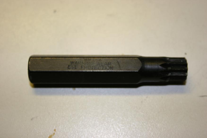

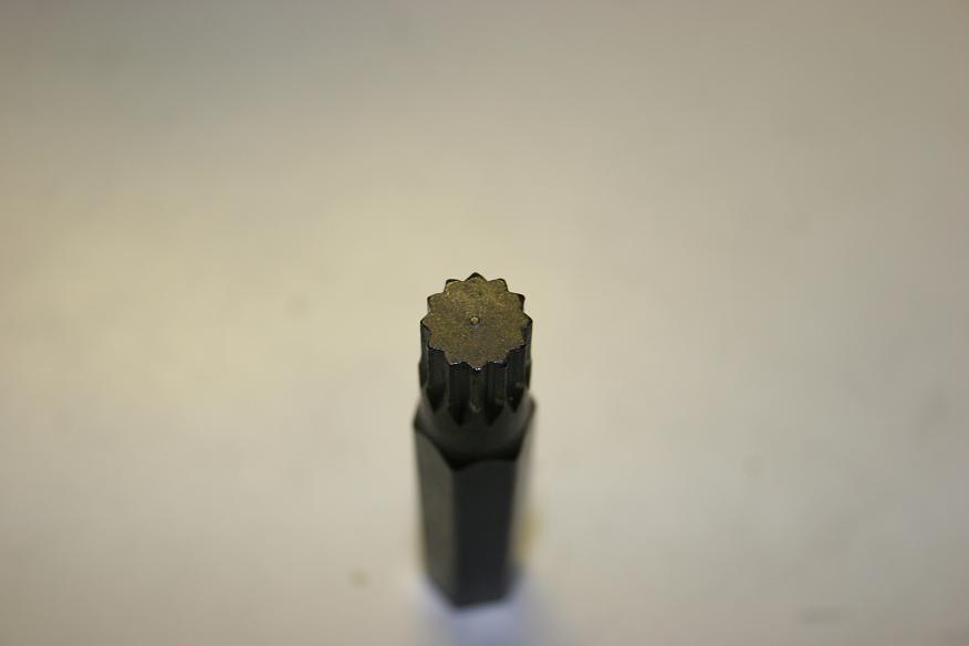

actually the bolt holding the steering wheel is not a torx, its a 12point serrated socket - 12mm. also, once connecting the batery you will get a traction control light on your dash. it will go away as you drive about 1/2 block.
