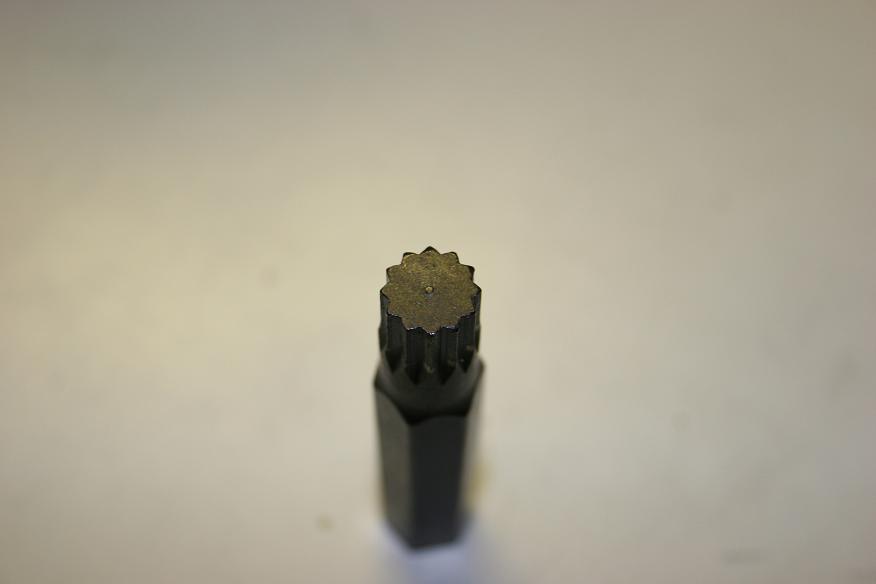

  6. Remove steering wheel center bolt *special tool needed*. You will need a 12mm multi-point tool. It looks like a large Torx bit with about 12 or 13 smaller ridges (A torx has 5 larger ridges). This tool is used for a few different things on Audi / VW cars as well. I do not know the exact name of this tool, I borrowed it from my friend. Slap the bit onto a 1/2" long ratchet wrench and turn bolt counter clockwise to loosen / remove. If you lock the wheel in the process do not worry, it is ok.

here's a few picture of the 12point serrated socket used in step #6

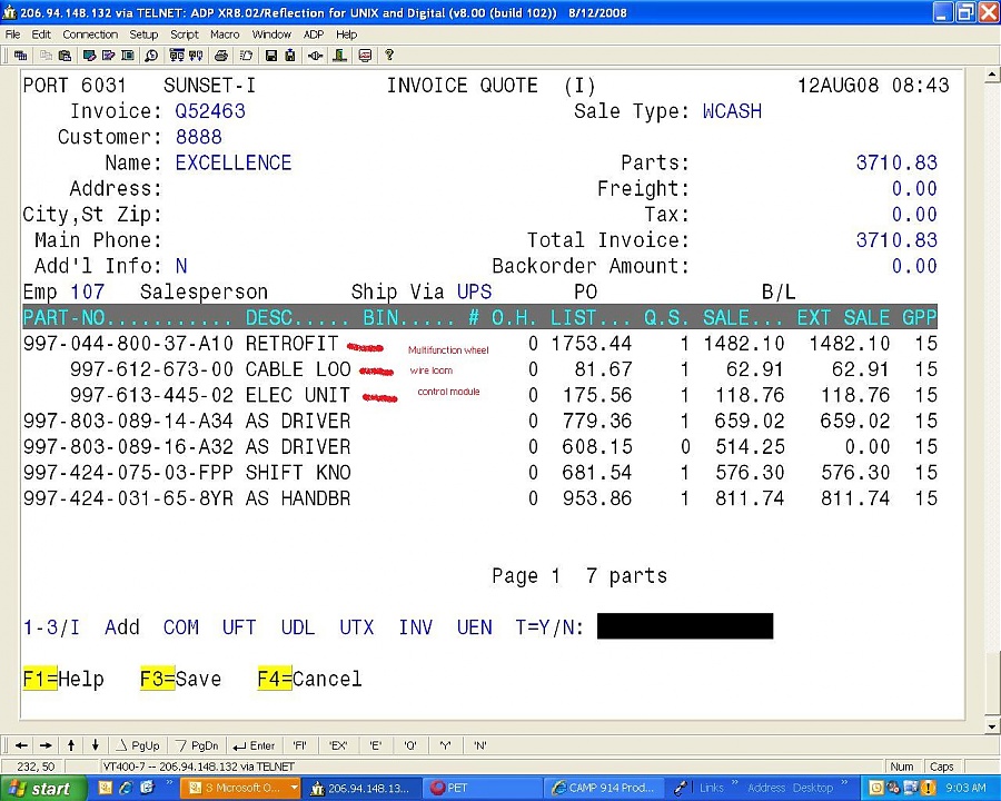

PET Schematic / prices for multi function steering wheel and control module
Here's some pics from Sunset Porsche:
1. PET schematic
2. Parts prices

You should be able to buy one, or a set, at local Sears, Canadian Tire or Lordco. I bought a set of different sizes of Torx drivers with 3/8" drive for about $20 or $30 at either Sears or Pep Boys here.

Ken- It's not a Torx, it is a 12pt tool. Kind of odd.

You're right, but I read here somewhere earlier this year that a 6 point Torx will work, and it did for me very nicely. Can't remember but I think it is a T-47 that works.

I just checked my notes. The driver I used was a 6-point T-55. Don't forget to apply lock-tite on the bolt when you re-install.

Ken- Yes the column wiring is the same for all cars. The only differences are inside the steering wheel itself.
The wiring harness is contained inside the steering wheel (behind airbag) and is different for each wheel. If you look at the PET schematic, there are three different harnesses shown. My standard wheel had the basic harness in it, a tiptronic has an extra plug shown, and the MF wheel has yet a couple more plugs.
Also, the MF wheel is the only wheel that uses a control module, which is also stuffed inside the wheel behind airbag.
Conclusion: If you buy a MF wheel used from another member, it will probably already have the control module and extended wiring harness inside the wheel. It should definitely be asked of the seller if these items are present. This makes the wheel "plug n play".
If you buy the MF wheel brand new from Porsche, you will only get the wheel. You'll need to order the proper wiring harness and control module. The wheel does not come with these items pre-installed. Does this help?
