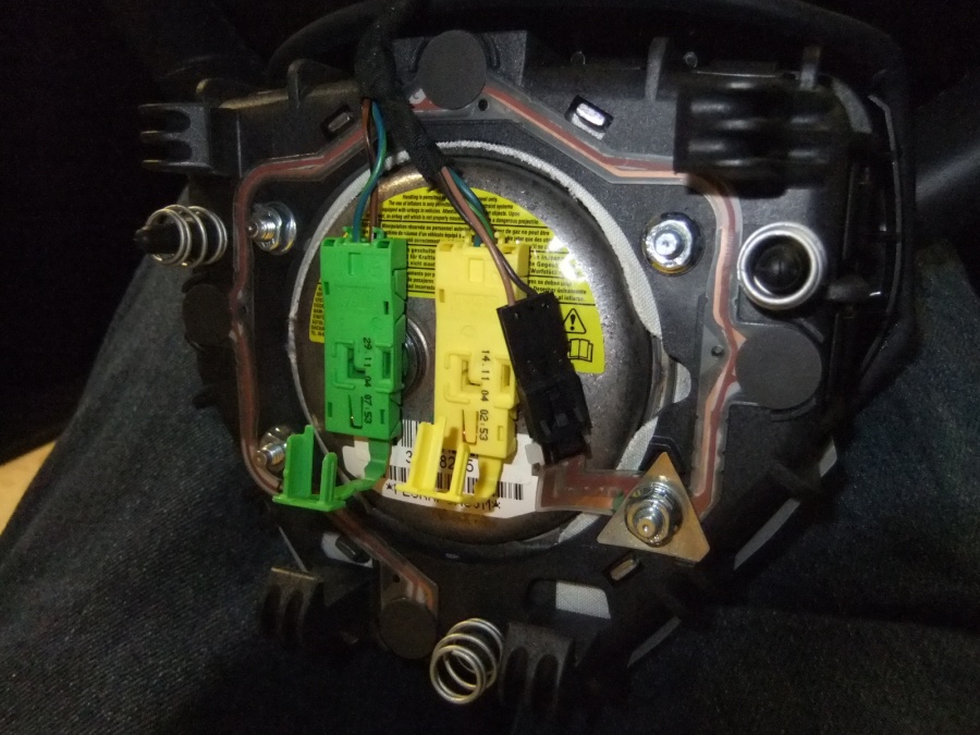

I easily got the air bag to pop out but how do I actually disconnect it so I can remove the steering wheel?
In the attached pictures I show the air bag popped out but still connected. I'm trying to get to this point below, where the green and yellow connectors to the air bag are released.
I have pulled the yellow and green tabs you can see in the photo above, but then what? How do I get thess two connectors to release from the air bag?
Thanks.

If you already release the tabs, just pull/jiggle the plugs straight out.

I got it. You just apply a little pressure and pull straight out.
