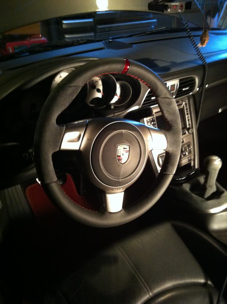

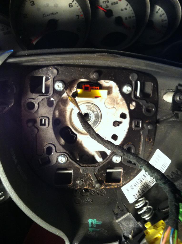

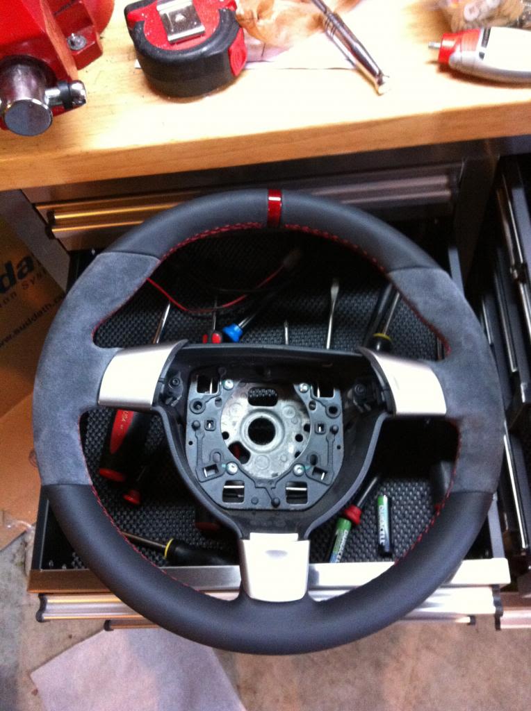

Old Oct 20, 2012 | 08:13 PM
  #104
DrVolkl's Avatar
Joined: Oct 2008
Posts: 920
From: Seattle
Rep Power: 71
DrVolkl has a brilliant futureDrVolkl has a brilliant futureDrVolkl has a brilliant futureDrVolkl has a brilliant futureDrVolkl has a brilliant futureDrVolkl has a brilliant futureDrVolkl has a brilliant futureDrVolkl has a brilliant futureDrVolkl has a brilliant futureDrVolkl has a brilliant futureDrVolkl has a brilliant future
Pics from my 2nd go at this... (new car). I can swap a wheel out in about 15mins now. lol
Thanks again MACarbon!
