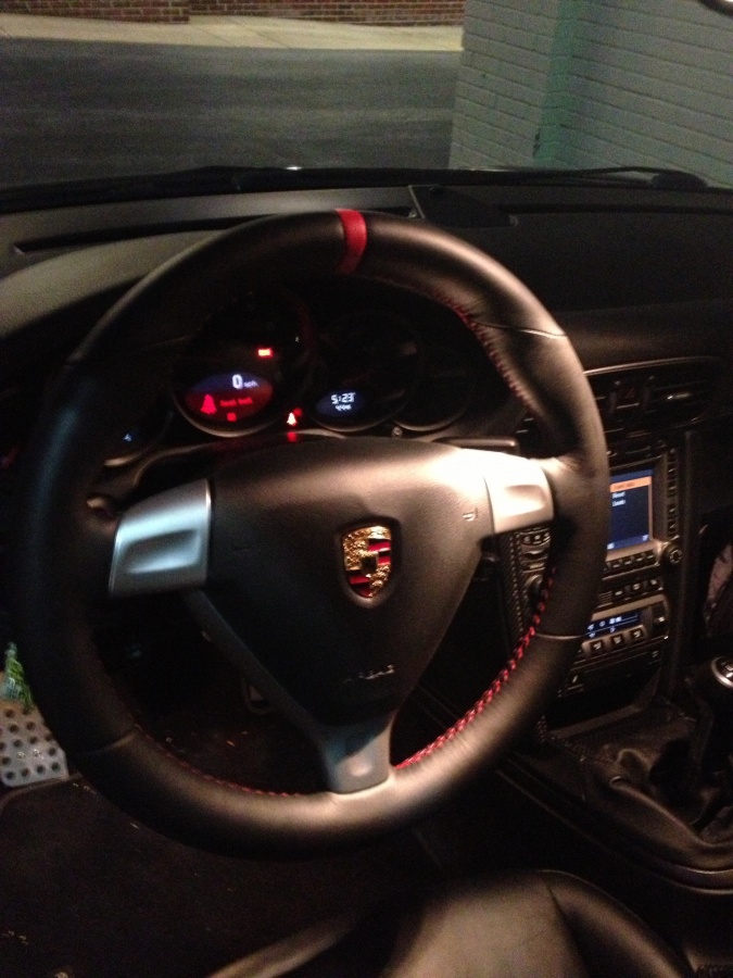

very nice steering DrVolkl

I just put my wheel on. It took 15 minutes and I did it at night. 10 of that was waiting the requisite 10 minutes. T-55 works perfect
