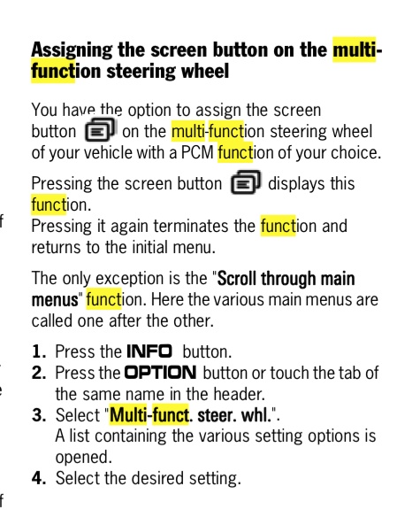

When you get it programmed please have them pay special attention to the PCM programming part, which enables the "multi function wheel" programming option for the screen button.
My dealer has been unable to solve this, and I would pay for a straightforward procedure I can hand off to them!

They got the car to recognize the wheel - the buttons all light up and work, and the PDK display also lights up for sport/sportplus/launch control.
What they didn't get working was the "Multi Funct Wheel" setting on the PCM which allows you to customize the behavior of one of the buttons on the wheel.
Specifically, this:
Hi Arcade,
PCM option is fully activated. Thanks for pointing it out. I specifically asked them to check that the option get turned on (thanks to your post.) I have about 6 options that I can set the menu button to (not sure which I will use yet.)
New wheel fully installed (by me) and programmed by dealer for $152 (all in). Pretty happy with the upgrade.
