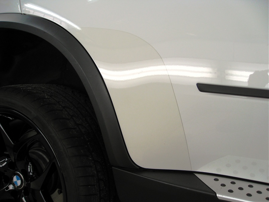

Awesome is relative. My purpose is not to start another "what is the best film" thread, but rather to inform people trying to choose a film for their car. This is pics of the top of the line Venturetape film after exactly 6 months after application in the NY climate. The film was waxed (the same wax we use on other brands of film) upon installation. Perhaps in a kinder climate it would not have discolored this quick. What I'm not saying is that other brands of film would not discolor; but I've seen many posts on different forums hyping Venturetape and raving about their lifetime warranty. This led to some consumers believing that the film will last a lifetime; which no film does. As far as the Venture warranty goes, the one time we called them to put in a claim (on a job which the dealership did) on a Scuderia, we were told in no uncertain terms that they would provide us with only with the material; the labor intensive part of removing and installing the film would have to come out of our pocket. The owner of the car was so pissed that he had us rip all of the Venturetape off and replace it with 3M.
Just my 2 cents of experience after being in the film game for almost 10 years.

dis-color vs. chips in paint...I would much rather deal with the bra and maybe extra expense than chipped paint.
