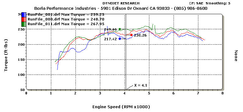

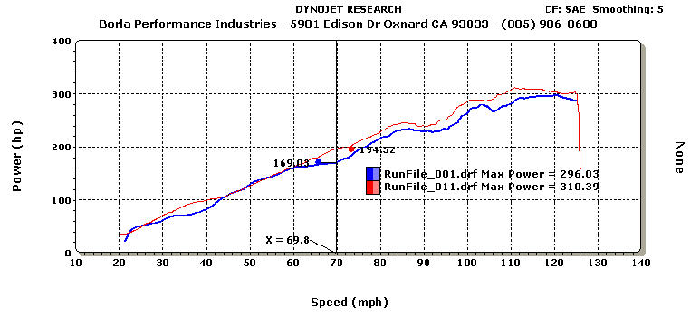

Dave,
I'm not quite sure of your background with dynamometers so forgive me if this information isn't new to you; it might be for others.
What we're most interested in is the delta, not the peak. While the data is data, how you interpret it will forever be up to speculation. It's our contention the debate of peak gains point-to-point loses significance if our parts are able to get you to that higher peak faster. You'll often hear aftermarket companies such as ours looking for the "area under the curve," meaning where our parts outperform the stock setup. While peak hp on a dyno sheet is great for bragging rights, it doesn't give you a complete picture of the performance-enhancing abilities of the aftermarket part.
Maximum gains at the peak of the RPM band are imperative in places like the Bonneville Salt Flats. However, on the street or track we would certainly trade a few horses at the very top for sizable gains in the low, mid, and upper portions of the band. Also, don't forget the advantages that low-end torque provide to the equation. To get to those mid & upper portions of the RPM band, increased torque will ease your car through the grunt work more efficiently.
I've included the same dyno sheets you saw before but now with two snapshots during the run cycle and legible values at the point intercepts. As I originally posted here, our headers & cat back net up to 26hp & 32ft-lbs of torque. The blue line represents the stock run & the red line has our cat-back & headers on. Keep in mind the X-axis terms "Speed in mph" and "Engine Speed RPMx1000" are interchangeable legend titles. Thanks for all your great questions; let me know if you have any more!
Enjoy the weekend,
Chris

Chris I am very familair with dyno's, I just wanted to point out the dyno you posted showed the 26hp at the widest delta. It wasn't peak hp/tq. I for one know that it's the midrange where your dyno shows the widest delta that I felt my increase with my parts. BTW, I plan on getting the Borla mufflers...just no one seems to have them in stock. Oh, and thanks for the dyno sheets..that's much better now. Much easier to decipher them.
Dave

The 26rwhp that Chris is talking about is the widest delta point. Peak hp is actually only a gain of 14rwhp with the headers and mufflers according to the dyno's that has been shown.
Dave
