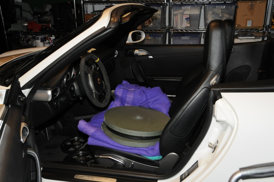

Well, I took the input provided by a number of helpful forum members (across a number of Porsche-centric sites) and spent the better part of today lowering and balancing the car - as best I could - prior to getting the final work done at the alignment shop. Why? Because it's fun putting a wrench to such a great car.
By way of background, I've been reading and planning on improving the suspension of my 2005 997S Cab, and decided on the Damptronic coilovers and H&R sway bars. I realized that doing the install was beyond me, but the local garage, who does do work on many Porsche's and an eclectic collection of exotics did the install but spent no real time attending to any fine tuning. In addition, they found that the car needed new front rotors and pads, so I had them install a set of braided stainless brake lines while they had the patient open. After a few quick drives, I strongly endorse this low-cost mod.
I chose to lower the car about 18mm from stock and, from a practical perspective, that seems to be about the upper (well, lower actually) bound of driveability - making it up driveways, over speedbumbs and the like. In a few days, after driving and letting it all settle, I'll take one more set of measurements and, if it all measures as set today, I'll have it aligned.
Even after just the initial drive, I think that the Damptronics/bars mod is the best price/performance enhancement you can make to the 997(s). As great a car as the 997 is, in stock form it is pretty sloppy in 'normal' PASM mode (the nose bobbing, the yawing under hard cornering), and useless in 'firm' PASM mode (so firm that the tires seem to lose a lot of contact with the road). It's much different now. Driving impressions to come after a few days of familiarization.
Here are a few pics of today's fun:
1. The 'before' photo - with the new stainless brake line;
2. A low-cost digital micrometer made it easier to make the adjustments;
3. Every auto geek needs a lab notebook for their experiments
4. Someone gave me a tip to pre-load the driver seat with my weight before making the adjustments
5. The final (for now) look of the car.
If you need some auto-therapy, I highly recommend both the mods and taking a few things into your own hands. It was a great excuse to buy a few tools, a nice way to spend an afternoon (while watching the NFL playoffs), and the sense of bonding with your car having done a bit of tune-to-taste.
