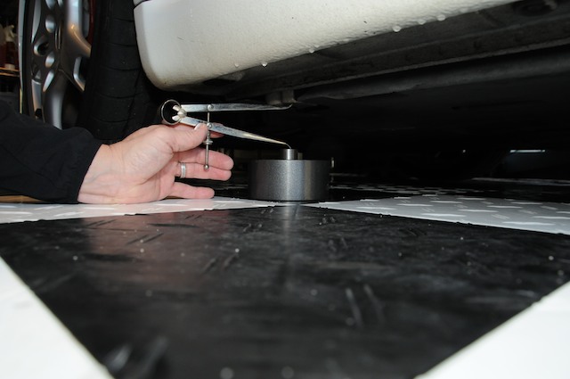

Yes, thanks. I spent some time with the car in my garage measuring the changes after the local garage put on the Damptronics w/o too much care or accuracy on getting the height and corner weighting right.
After a bit of measuring and calculating (I still need the proper initial OEM benchmark measurements and technique that I can check and reproduce) it seems like the 20mm drop originally recommended will be too low.
I'm likely to set it to 15-16 mm tomorrow and see how that works. Fun project. though.
