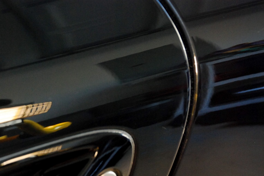

I've used a Porter Cable 7424 (dual action) polisher for years. I was going to take the plunge and get a DeWalt Rotary or a Flex, but right before I pulled the trigger I tried a different polish (Menzerna Super Intensive Polish) and got the results I wanted.
My cars have all been black, which is the most difficult. I thought for sure, with the damage an ill advised trip to a car wash inflicted, I'd be forced to use a Flex or a Rotary to get the swirls and scratches out. But I was able to do it successfully with my PC, Menzerna SIP, and an Orange pad.
If you can get the job done without going to the rotary, I think you're better off.
The Flex CAN burn paint, and a rotary absolutely can. Tread cautiously if you've not used either before- get a lesson from a seasoned detailer.
The mantra is always: use the least aggressive products and techniques necessary to get the job done. You don't kill a fly with an uzi.
If you've got some time and patience, and the right combination of pads and polishes, a PC is a very versatile tool.
Here a before and after pic of my car, as well as a link to the thread where I detail the process/ steps involved:
https://www.6speedonline.com/forums/...ur-detail.html
