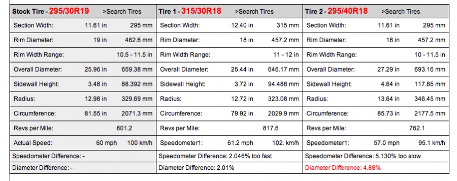

I haven't run the Falken tires, but will say that you should be running 315/30/18 in the rear on a 11-12" wheel, the 295/40/18 will be too tall.

but dont you need a taller tire to compensate for the 1" in diameter lost in wheels size?

Technically to keep the total diameter the same dont you need to:
19"
235/35/19
295/30/19
18"
235/45/18
295/40/18
These should keep the overall diameter around the same.
So going any lower profile will lower the overall diameter... ????

No it should be 295/35/18 and a 235/40/18 will get you near the same tire diamater. Going to a 40/45 series tire will make you about 1" too tall.
Keep in mind the above tire sizes I quoted are actual Pcar sizes used on 997's with 18" wheels.
If you are going to track the car though I would go with the widest tire possible such as the 315 that NorthVan recommended. Also go with the widest tire possible on the front ala. 255/40/18's on the front if you have the proper offset. You never mentioned what wheels you are going to be using.

Dave, I agree that the 295/35/18 is the better size, but good luck finding one for the track. I originally ran 18" wheels and tires at the track, and couldn't find the right tire sizes to work with the 997. I went to 19" wheels and run OEM tire sizes for the track.
As for a the 18 inch comparison of the two tires, here is a chart that will show you what your net results will be.
