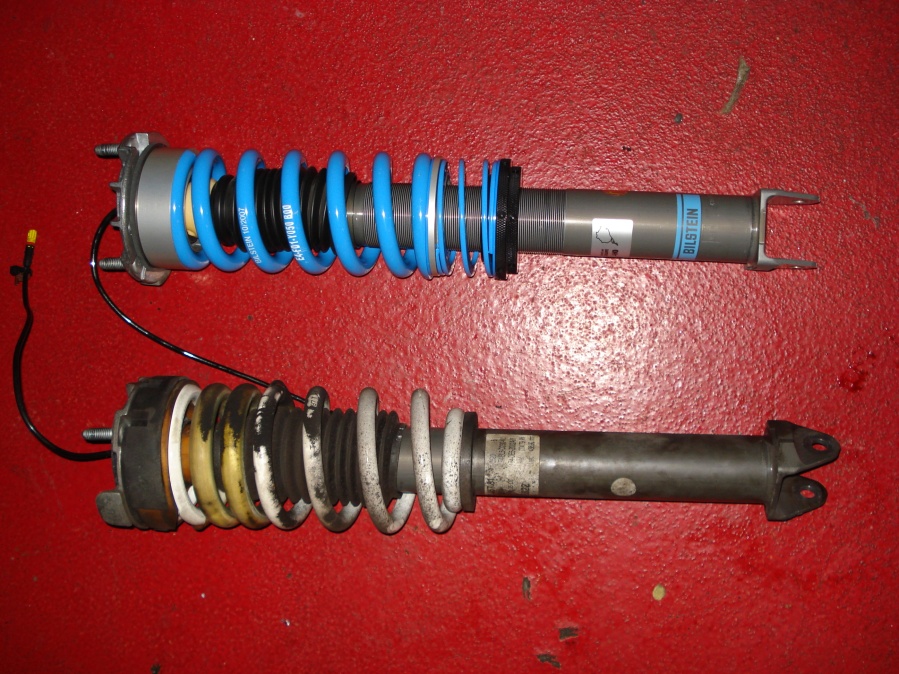

I read it . I see mine but remember I have a Turbo with PASM . Here's a pic next to my former Techart spring .
