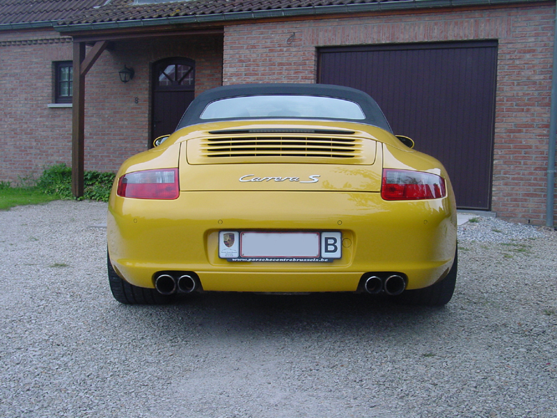

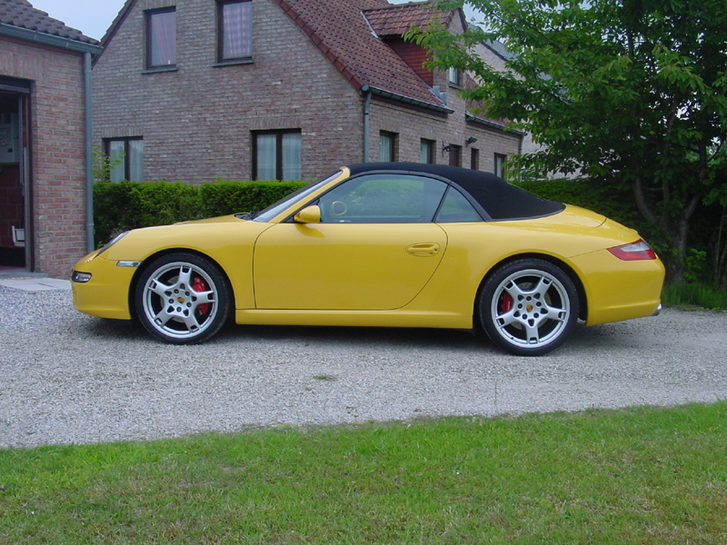

Hi ,
yes it will fit : i have oem C4S wheels on my C2S , no problem
As told , it's like having stock C2S wheels with 16mm spacers --> looks clean
Here is a pic from the back and side :
See ya all and have fun
Nico
