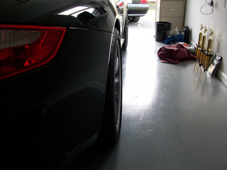

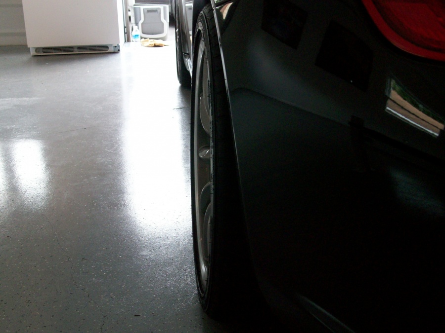

Keep in mind the Sport Design and Lobster rims others have mentioned are 11inch in the rear. Your Carrera Sports are 11.5inch. This half an inch additional width needs to be factored in. A 15mm spacer will definitely extend the rim beyond the fender lip. I don't think you will be happy with the look.
Attached are pics of mine with 305 Bridgestone RE050A and an OEM 5mm spacer. It's near perfectly flush to the lip.

Keep in mind the Sport Design and Lobster rims others have mentioned are 11inch in the rear. Your Carrera Sports are 11.5inch. This half an inch additional width DOES have an impact on final offset. A 15mm adapter will definitely extend the rim beyond the fender lip. I don't think you will be happy with the look.
The 5mm Spacer seems quite right on yours

Wow hattrick - 5mm does indeed look almost perfect. Might have a set of 15mm H&R spacers + bolts here for sale soon...
Thanks for the pictures. I believe I'll be looking for a 5mm kit now for the rear.
