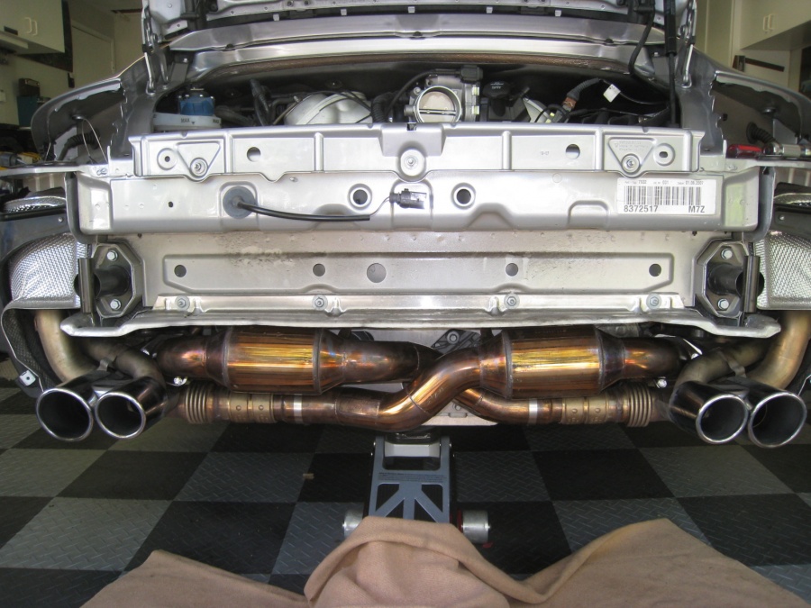

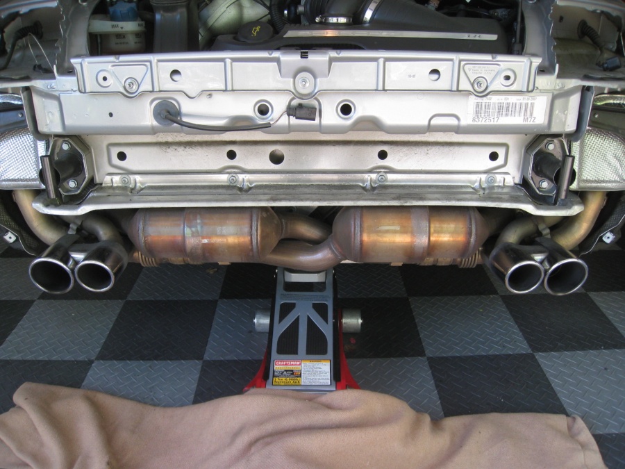

Installed High Flow AWE Cats today
Picked these up from fellow 6speedonliner last week and installed them today. I pulled the rear bumper to make access easier, and it helped a lot. It would have been easier if the flanges had studs like the factory cats, since the bolts I purchased need to have a wrench on the back side to tighten the nuts, and there isn't a lot of room in there. Had to pull the air box to allow O2 sensor wires to be moved sufficiently to reach the new positions.
I love the sound of the cats with my PSE mufflers and X51 headers. With PSE in quiet mode, the sound is just a little deeper but not too noticeable until higher revs. But with PSE in loud position, the car barks nicely.
Before (large cats), After (smaller cats):
Congrats on work well done.
Is it really safe for 997 to lift it like this at this center spot below engine? I`ve read it is not really advised.
