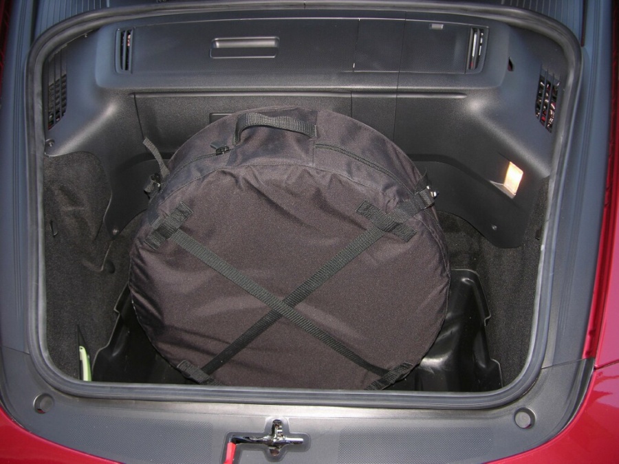

Just to resurrect this thread briefly, this is the kit I purchased from Suncoast Motorsports last week (thanks to Ric Knab for his help in putting it together).
987-722-061-01 Tire cover (old part number 987-722-061-00)
996-362-020-04 Emergency wheel (old part number 996-362-020-03)
996-722-101-00 Emergency wheel insert
996-721-211-00 Jack
The tire cover is canvas, zippered, and has four straps on one side with clips on each end. Inside the "frunk" there are two screws attaching the inner cowling that would be in line with one of these straps. I'm going to talk to my company machinist to see if we can get creative with some aluminum attachment points using these screws.
Here are a few photos, just for the record. For those that are interested, the inner diameter across the plane of the wheel attachment plate is 15.75" For a 997.2 Carrera (no S) without the PCCB's, this looks like plenty of clearance for the brakes.
Does anyone have a suggestion for a wheel lug wrench that would complete the kit? How about a decent torque wrench as well?

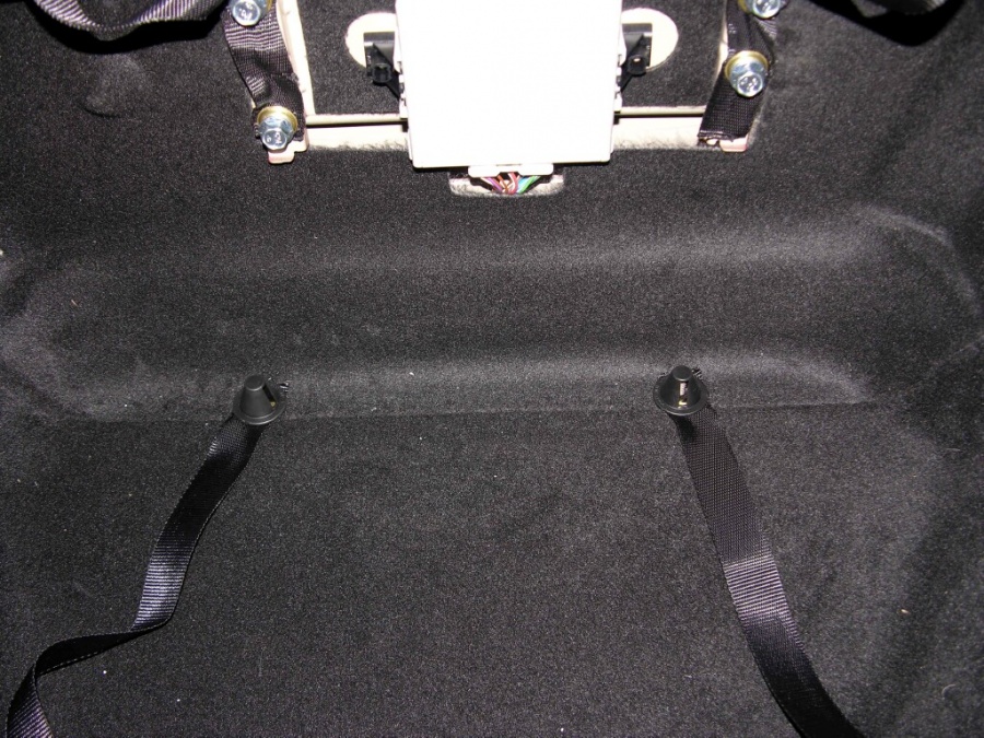

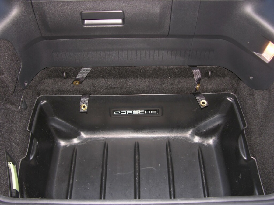

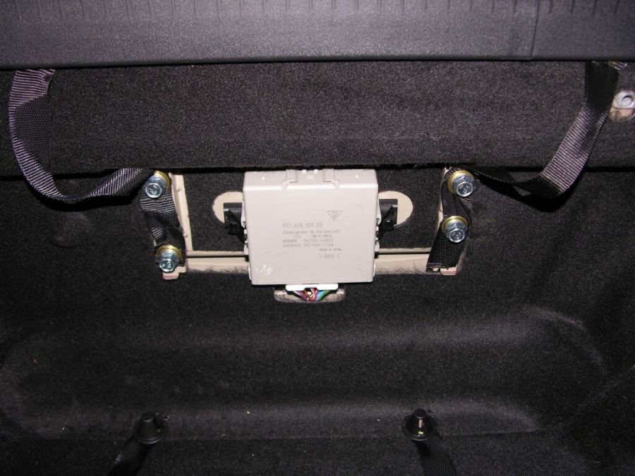

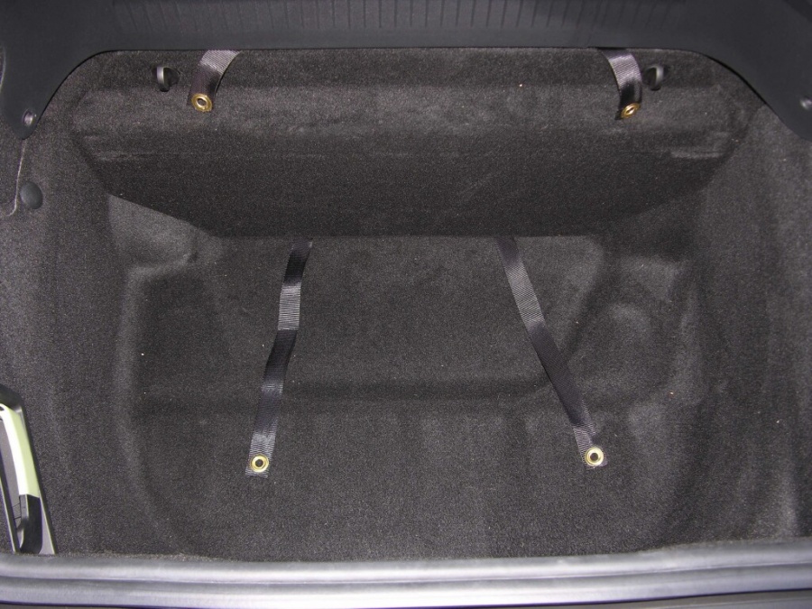

Here is an approach I used to temporarily mount the tire, while I search for a better method. When you remove the air compressor housing on my 997.2 C2, you expose the mount for the dynamic cornering lights controller which is welded to a bar that runs horizontally across the back of the "frunk". There are two, fairly sturdy tabs on this mount that have two holes each that will clear an M8 bolt. Using some 1" wide nylon lashing strap and a tarp eyelet kit, I created two custom straps that could be mounted to these tabs. The other end of each strap has another eyelet for connecting to the tire cover clips. That covers the top two clips.
For the bottom two clips, I removed the black "cones" that locate the base of the compressor housing mount and attached two more lashing straps to the exposed posts with a thin walled nut. This allowed me to replace the cones with the straps attached. The bolts in this location are fairly small in diameter, so I don't expect them to take a lot of force without bending. Hence the temporary nature of this solution.
Replacing the compressor cover now leaves the ends of the securing straps exposed. I deliberately made the bottom straps longer than necessary at this stage since I wanted to use the tub liner I bought for the car for added support. Final photo shows the tire secured with the straps on the tire cover attached to the custom straps. The fit is very snug, but not solidly tight.
Using the tub liner raises the tire height to the point where you would worry about the hood coming in contact with the tire. Fortunately, the highest part of the tire slips into the space above the location where the cross welded hood struts come together. The hood closes without contacting the tire. However, I do recommend a Das Schild hood protector if you decide to try this.
Has anyone come up with a better way for the 997.2?
