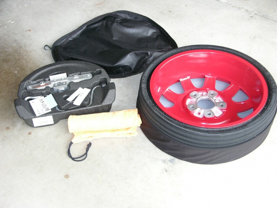

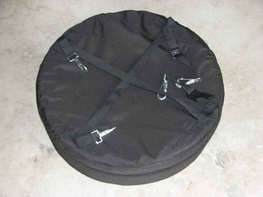

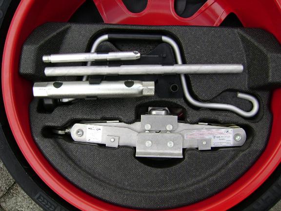

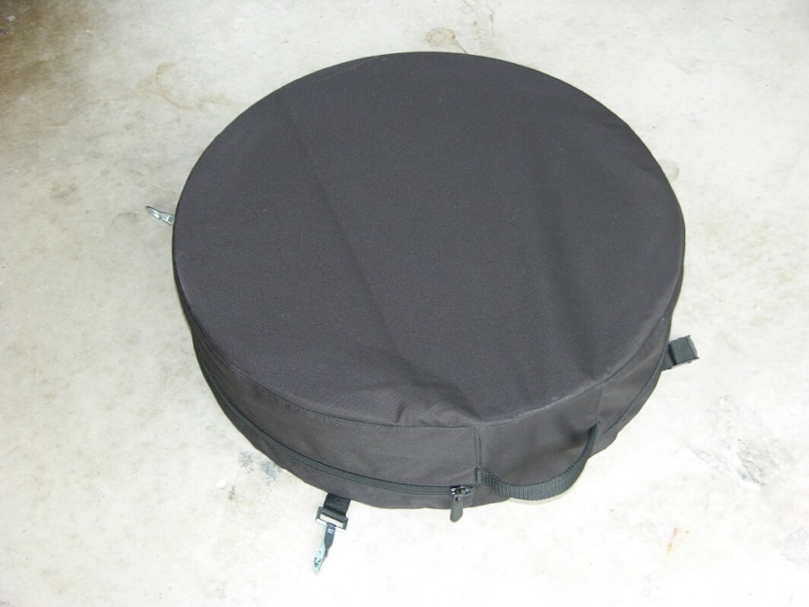

Just to resurrect this thread briefly, this is the kit I purchased from Suncoast Motorsports last week (thanks to Ric Knab for his help in putting it together).
987-722-061-01 Tire cover (old part number 987-722-061-00)
996-362-020-04 Emergency wheel (old part number 996-362-020-03)
996-722-101-00 Emergency wheel insert
996-721-211-00 Jack
The tire cover is canvas, zippered, and has four straps on one side with clips on each end. Inside the "frunk" there are two screws attaching the inner cowling that would be in line with one of these straps. I'm going to talk to my company machinist to see if we can get creative with some aluminum attachment points using these screws.
Here are a few photos, just for the record. For those that are interested, the inner diameter across the plane of the wheel attachment plate is 15.75" For a 997.2 Carrera (no S) without the PCCB's, this looks like plenty of clearance for the brakes.
Does anyone have a suggestion for a wheel lug wrench that would complete the kit? How about a decent torque wrench as well?
Hope this info helps.
