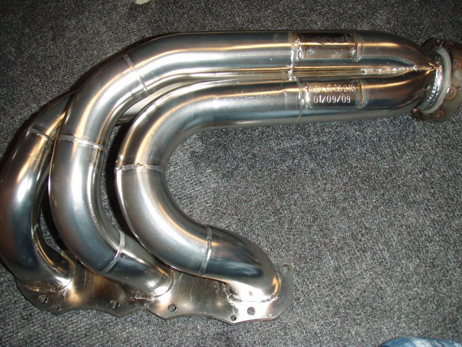

Headers, 200 cell cats, side mufflers.

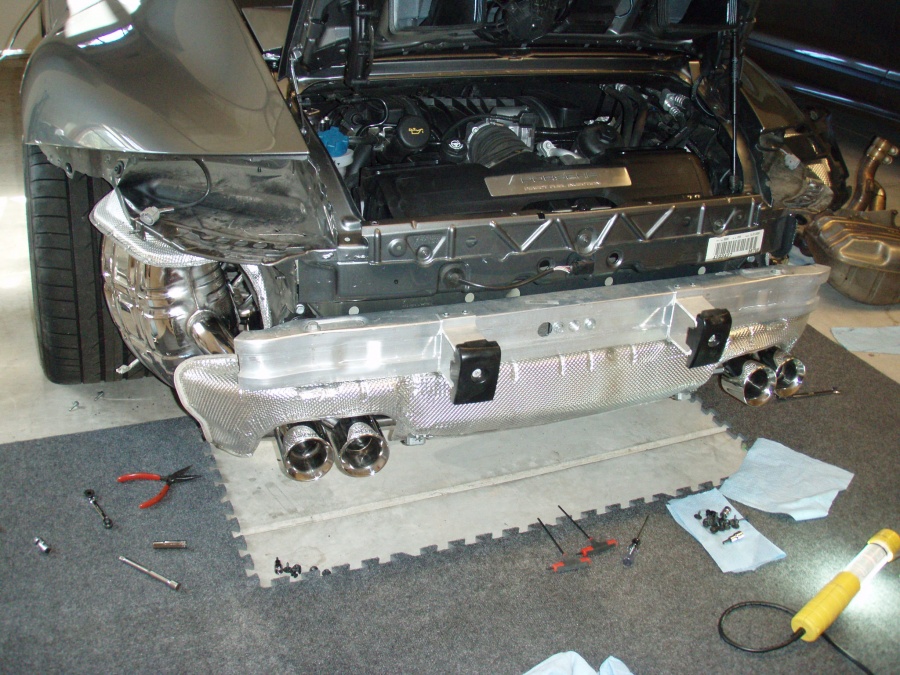

I did the install myself with the car on the ground. Not recommended for the faint of heart, but it can certainly be done if you have the tools and some time.

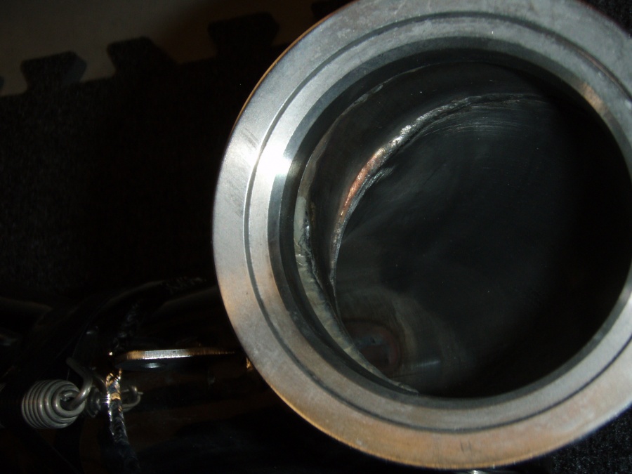

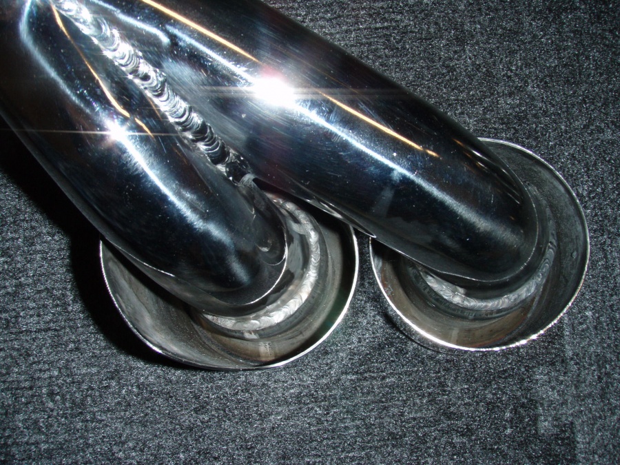

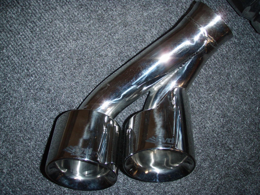

The quality and look of the FVD Brombacher exhaust system is amazing. The connectors are extremely high-quality The welds are very well done, the look inside shows the care to blend in and smooth the gas flow path. The outside finish is like a piece of jewelery.

Delivered yesterday. So I got up early this AM and tackled the install. Pretty straight-forward, plenty of adjustment for fit. Sturdy mounting. Superb quality.
