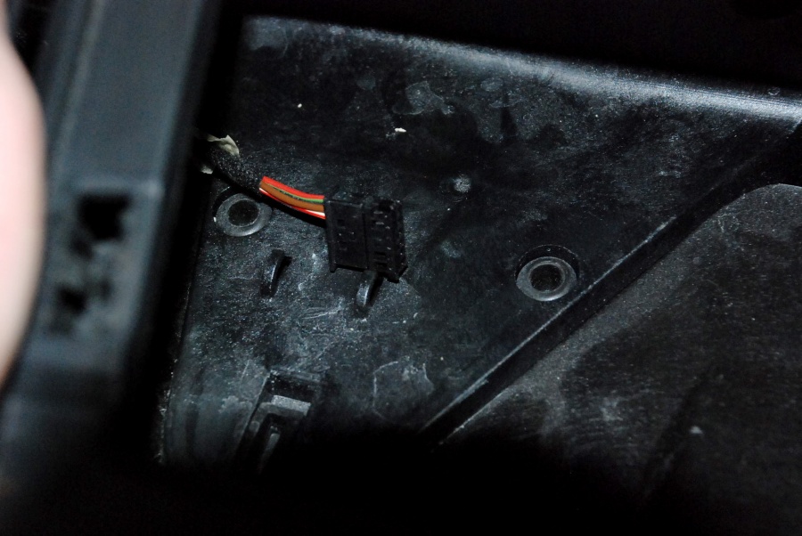

Attempting to connect a 2 yr old Dension Gateway 500 to my '05 997S.
The MOST loop is done but PCM 2.1 says "amplifier not available".
I am now ready to connect the power and ground, but it seems silly to solder when I can just use wire caps.
Here's the question:
1.) is it normal for my PCM 2.1 to display the "amplifier not available" error message until I connect power to the Dension unit?
2.) I have no CD changer, but the car is wired for it. To provide power to the Dension unit, I am suppised to "tap into" that connection. Does that mean cutting off the black plastic connector to access the ground and power wires?
Here's a pic of the wiring for the CD changer. I am about to chop the black plastic connector end off of it, to allow my access to strip the ground and power wires. Yes or no?
CATTMAN

1.) Yes it is normal to get an amplifier not available signal until you complete setup.
2.) Dont chop off that black plastic connector, just in case you end up needing a cd changer in the future. Just go to radio shack and buy a wire splicer.

Too late, I hacked it off! No worries, why would I need a CD changer if I haven't already, and now that I'll have a dedicated iPod.
It's working! Wow, it was so easy to DIY, can't imagine paying $200 to get someone else to do it. Now, paying someone to teach me how to use it? Naahh, a 5th grader can show me in about 30 seconds.
BTW, why would anyone solder this stuff? There are just 2 wires, ground and power. Isn't soldering it over the top when one can just as effectively and more easily use twist caps and some electrical tape? What am I missing here?

Soldering is easy and won't vibrate loose.

Yikes! This isn't home electrical wiring. At least use crimped butt connectors if you aren't going to solder. Twist caps should not be used in automotive wiring. Think of the cost of a short - nothing electrical on a p-car is cheap.

Seems pretty secure. I suppose I could get it soldered professionally pretty inexpensively though.

Cheaper to buy your own soldering gun and some solder. Nothing hard about it at all.
