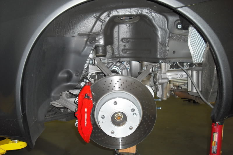

Front strut removed.

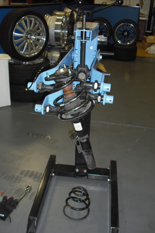

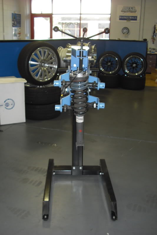

We use a "Strut Tamer", to compress springs. This is the front strut being compressed for disassembley.

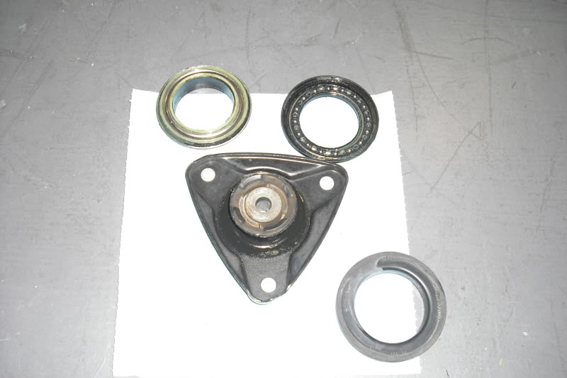

We cleaned and regreased the upper spring mount bearings.

Front Strut with new Eibach Spring, sorry but didn't get a good picture of this reinstalled.

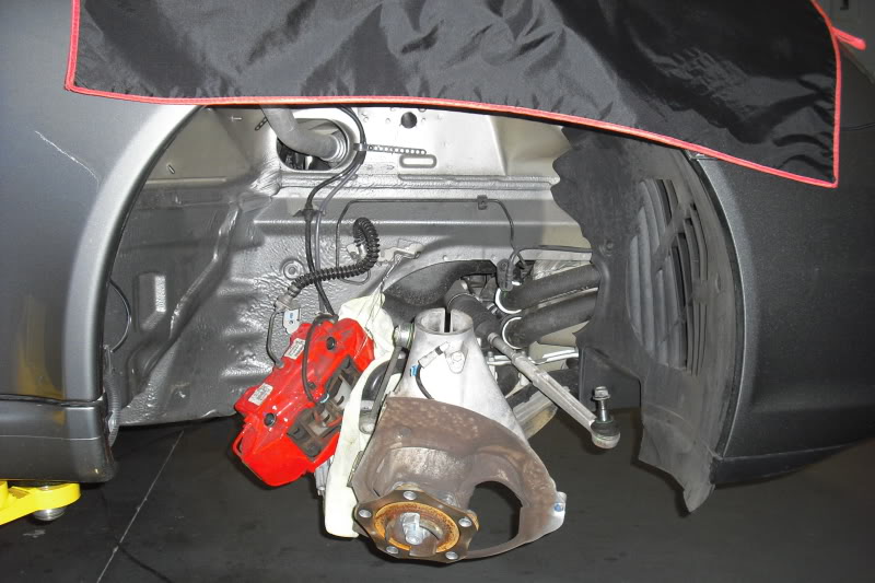

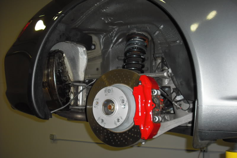

Rear Strut removed.

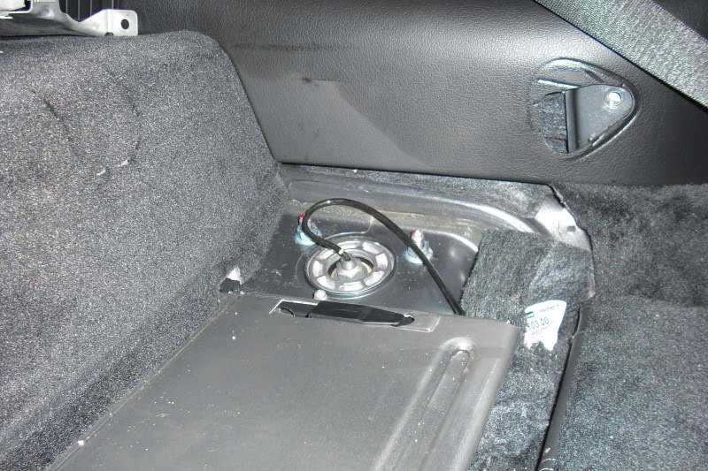

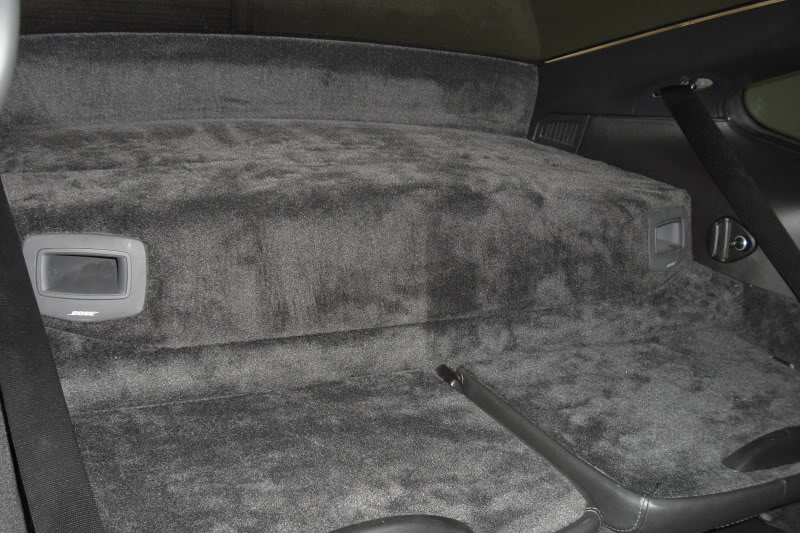

Need to access the rear top mounts through the interior.

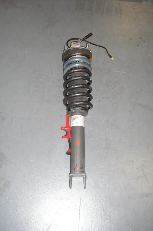

Rear strut with stock spring.

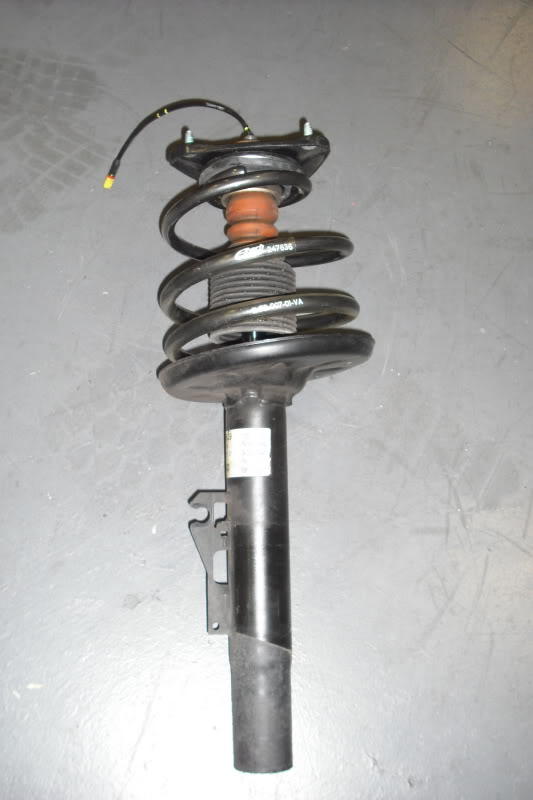

Rear strut with Eibach Spring.

Interior put back together.
