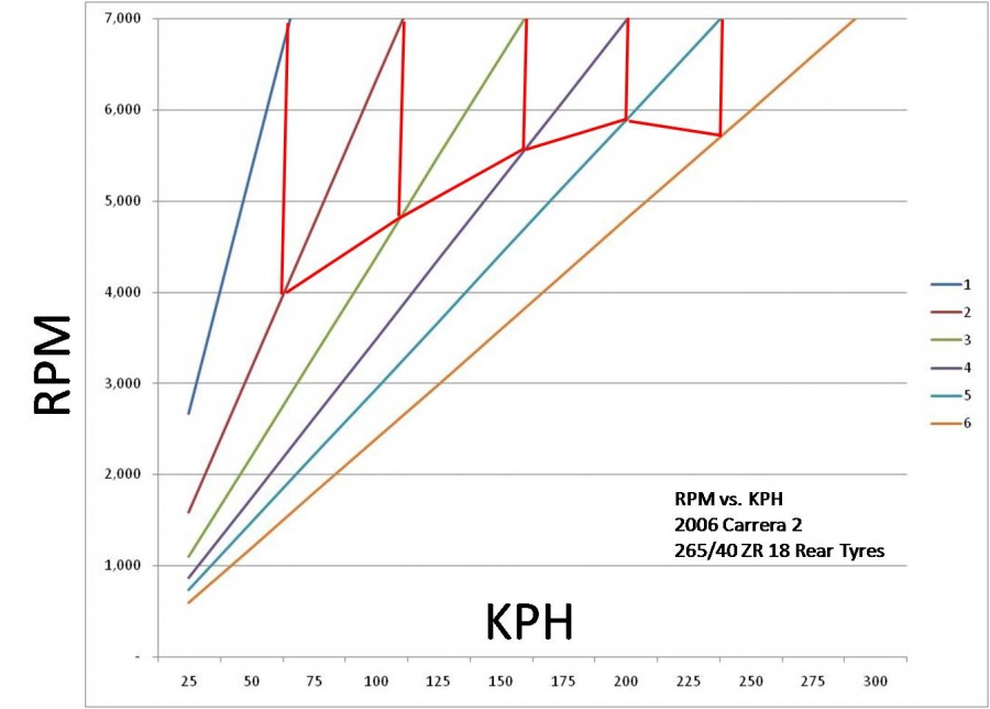

I try to upshift at about 6500 rpm if I am pushing the car. I always take note of the maximum speeds in each gear when downshifting at higher rpms. Finally, my shfts are deliberate two-step shifts. I feel this minimizes my causing damage to the engine even though it might be too conservative for some. The only sure way to prevent over reving the engine is to go with an automatic.
