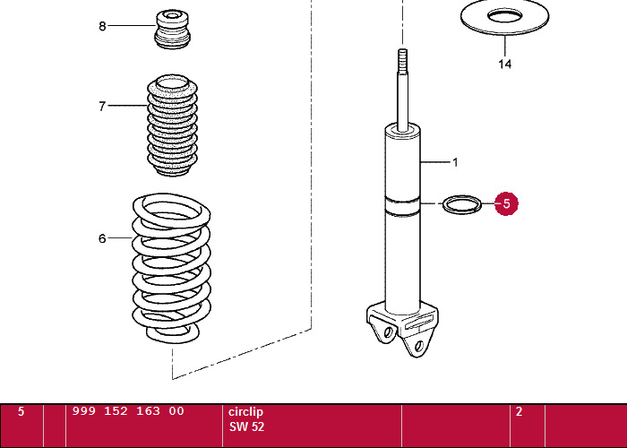

I snapped a shot, and this is what I came up with. You see the number 5, there are two dimples on the shock absorber. The guy at Porsche said they could change the setting from top to the lower level.
I dont know if its lowered by 10 or 20 mm, thats what I'm gonna check tomorrow. What do you think?
Are you talking about the stock shocks being height adjustable? Please say this this is true!
I've checked under the car last week, yes there are dimples on shock absorbers, and the tech guys, if not misleading me, told this could be applied. I'm gonna go tomorrow to check for sure if its possible with photos. If you could, please ask around also.
I'll be checking on this tonight. I have PASM shocks though, so may not be the same as non-PASM.

Sorry, I forgot to post here after I checked, but my car does NOT have height adjustable shocks. My car is a 997.1 S with PASM.

Its more like the shock dampers have two dimples on them, I've checked mine, lowering it in 10 days after I receive my cargo But I dont know why some cars have them and some dont.
