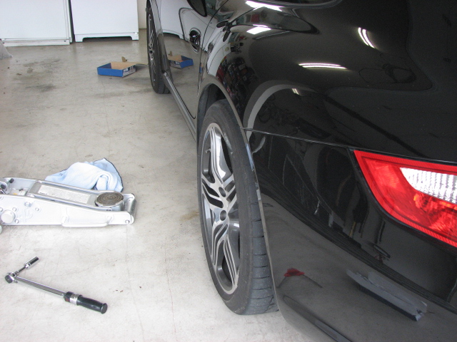

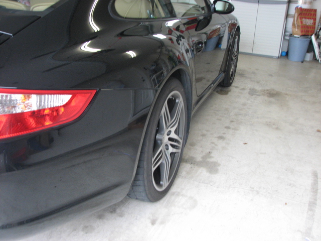

Installed H & R 15mm rear spacers...installed OEM 5mm front spacer also...now I have to drop this car by 15-20mm...
Driver rear is with 15mm spacer and passenger rear is without spacer...pics dont show the very noticeable difference very well.

You've changed the rear offset from 67 to an effective 52. Very close to the stock turbo rear offset of 51. Looks like a nice fit - 295 tires I presume. Those are obviously the narrow body fitment turbo style wheels. I have the turbo wheels with 305's and they are even more aggressive to the wheelwells, perhaps a little too much.

No...I bought the OEM turbo wheel with 57 and 51mm offset...I have C4S so my lobsters that were removed were 57 and 51mm offset....running 305's in rear.

looks perfect. nice torque wrench, btw.

so the wheels stick out more, what about the gap between tires and fenders? did it decrease the gap at all? (or at least look like it did?)

Thats my next task!...no, it didnt help at all with the fist size space between wheel well and tire...as noted above, car needs to be dropped 15-20mm imho...gotta order me some Damptronics when my wife not looking....
