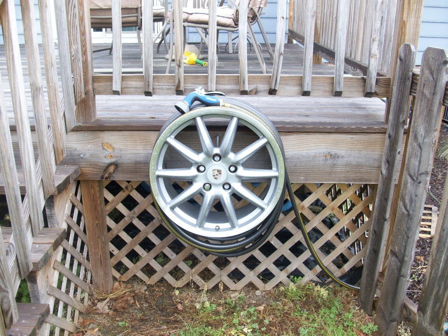

At the very least, you've got yourself a nice garden hose/wheel-reel !
